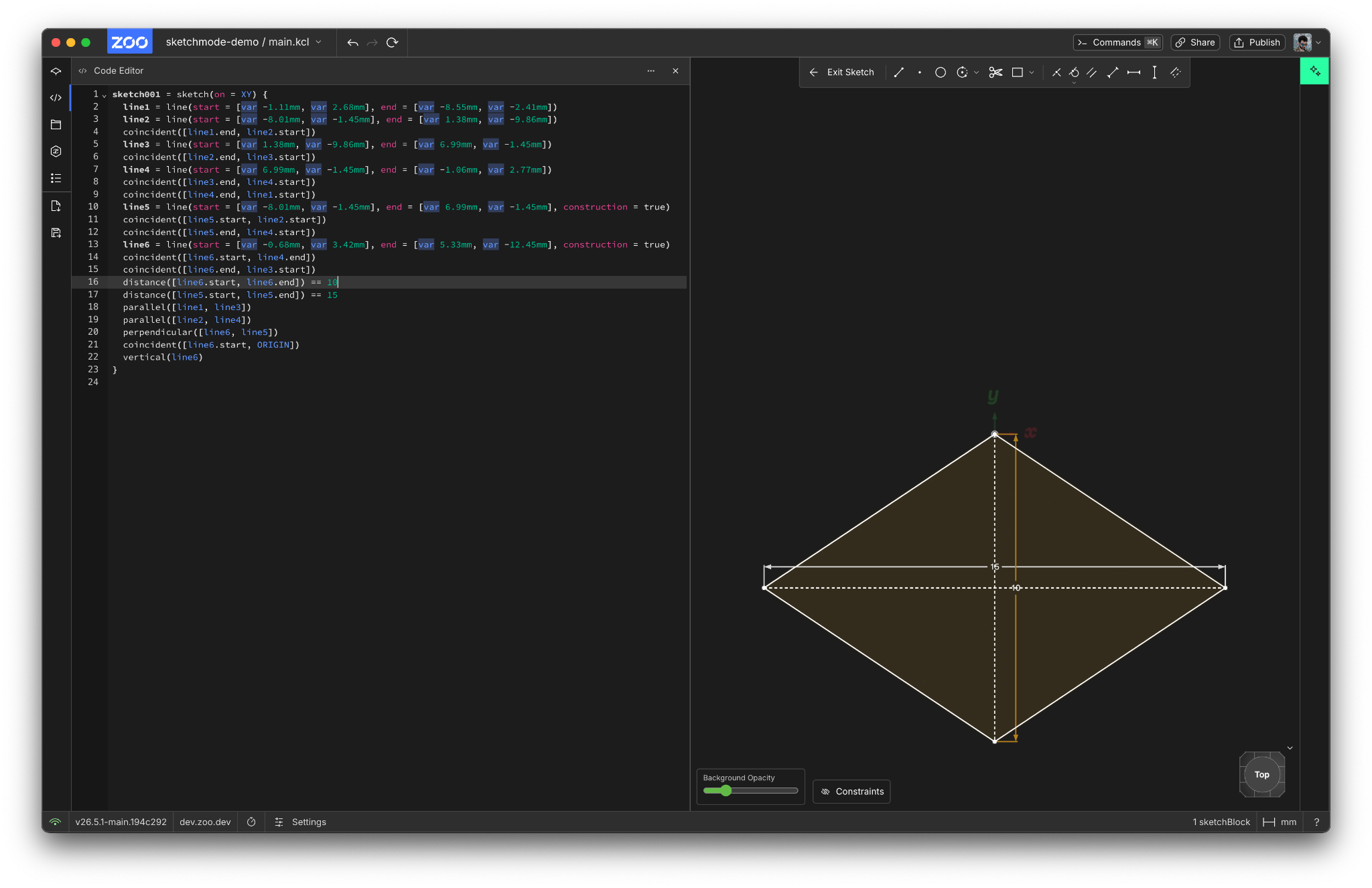

Mechanical engineers love the new point-and-click constraint solver, but programmers can also access this powerful new tool. All Zoo models are actually, under the hood, stored as code. If you open up the Code panel, you can view this model's source code. It's written in KittyCAD coding language (KCL).
Rhombus sketch, showing the KCL code for it

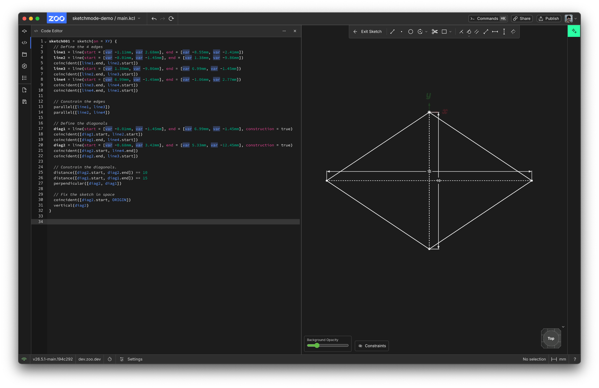

This code is human-readable, but it was generated by the point-and-click UI actions I took. I'm a programmer, so I like my code to be neat. So while I've got the code panel open, I'm going to add some comments, organize my code into related themes, and rename some variables so I know which lines are diagonals and which are edges.
KCL refactored to be more readable
There, that's better. You can see KCL's new "sketch block" syntax, where I open a sketch on a certain plane (XY) on line 1, and then add geometry and constraints within the block. Sketch blocks let programmers declare their intent, just like mechanical engineers do. Previously, KCL made you specify each line of geometry exactly. But now, programmers can define underspecified geometry and add constraints to it, then let the constraint solver work out the exact position of every little point and line.
