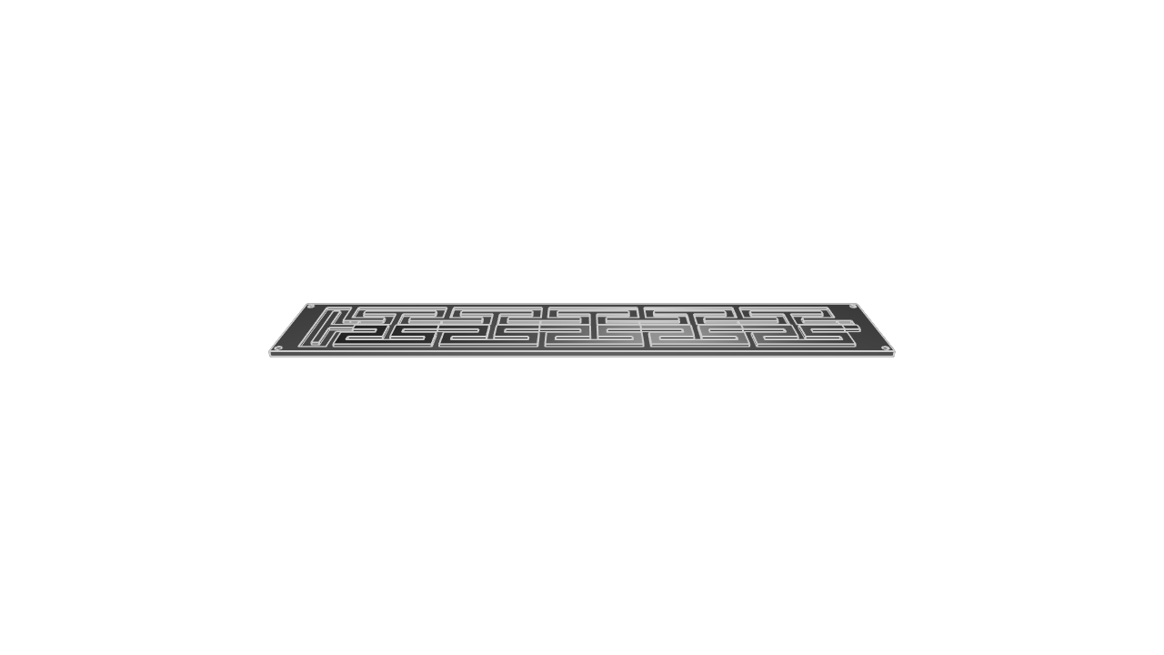

// Battery Module Cooling Plates
// A battery module cooling plate is a thermal management component used in battery packs—particularly in electric vehicles (EVs), energy storage systems, and other high-power applications—to regulate the temperature of individual battery cells or entire modules.

// Draw one half of the cooling sketchs
coolings = map([0 .. numberOfCoolingsPerSide - 1], f = drawCoolingSketch)
// Draw the other mirrored half of cooling sketchs
coolingsFlipped = map([0 .. numberOfCoolingsPerSide - 1], f = drawCoolingSketchFlipped)
// Draw the cooling sketch that connects both halves
headOfTableCooling = coolingSketchNoArms(plane = basePlateEndFace, startPoint = [0, 0])
  |> rotate(roll = 0, pitch = 0, yaw = 90)
  |> translate(x = startY, y = startHeadOfCoolingY, z = 0)
  |> extrude(length = -csgCuttingDepthThicknessOfChannel)
