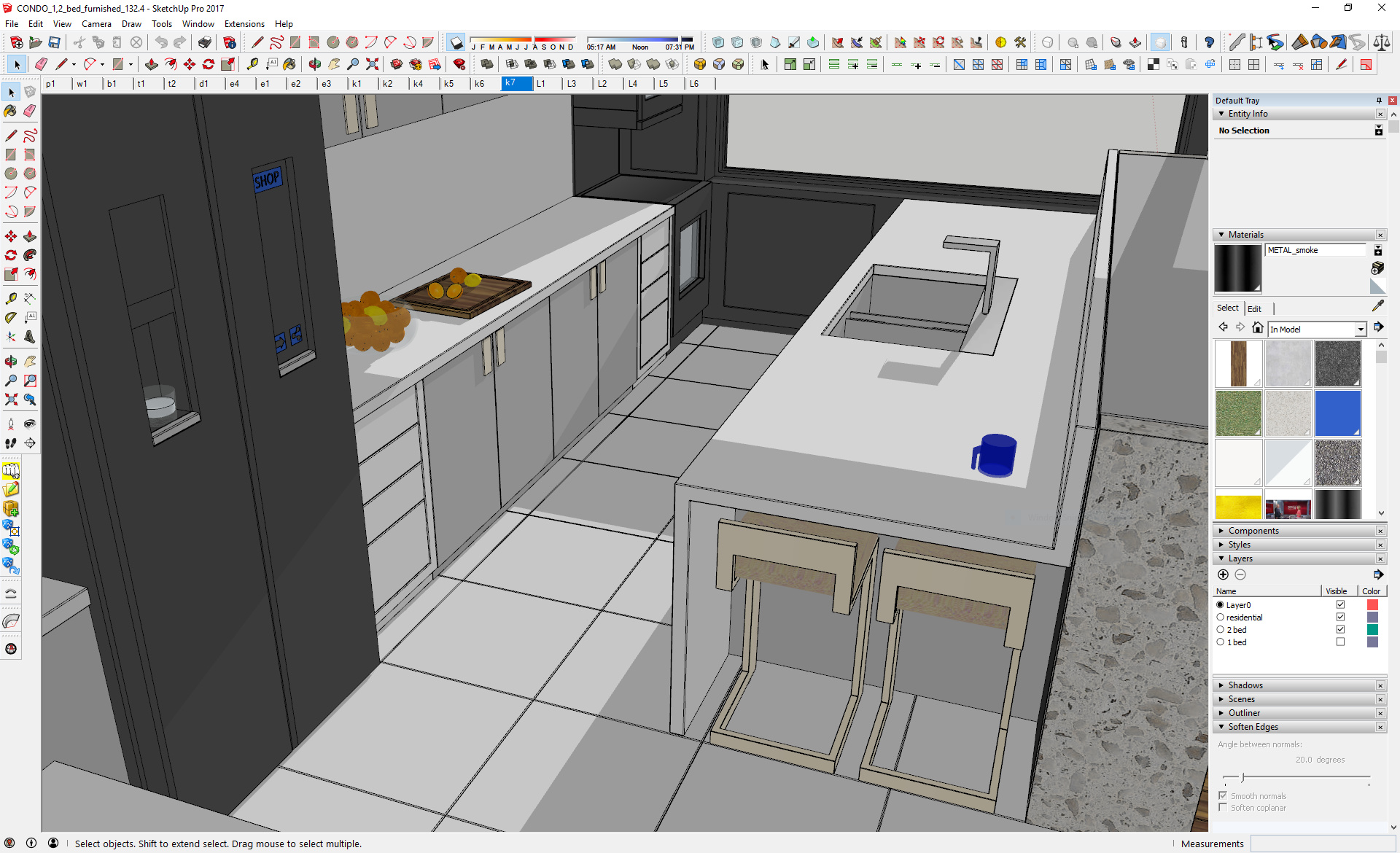

SketchUp
Figure 1: SketchUp. A user-friendly, conceptual tool with polygon-based modeling.
Credit: SketchUp Forums

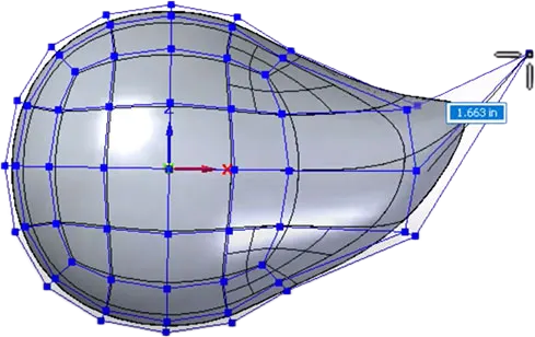

Siemens NX o
Figure 2: Siemens NX. A precision engineering tool with NURBS-based modeling.

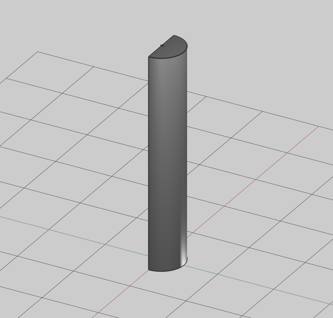

If T(v)T(v) is a perpendicular straight line, then S(u,v)S(u,v) simplifies to an extrusion surface with M(v)=iM(v)=i for all vv. Similarly, if T(v)T(v) is an arc, then S(u,v)S(u,v) will be the surface of revolution.
Figure 5 and Figure 6 illustrate the case where a sweep simplifies to an extrusion.
Extrusion Example
Figure 5: Sweep profile and perpendicular trajectory curve.
Extrusion Example
Figure 6: Completed sweep (extrusion).

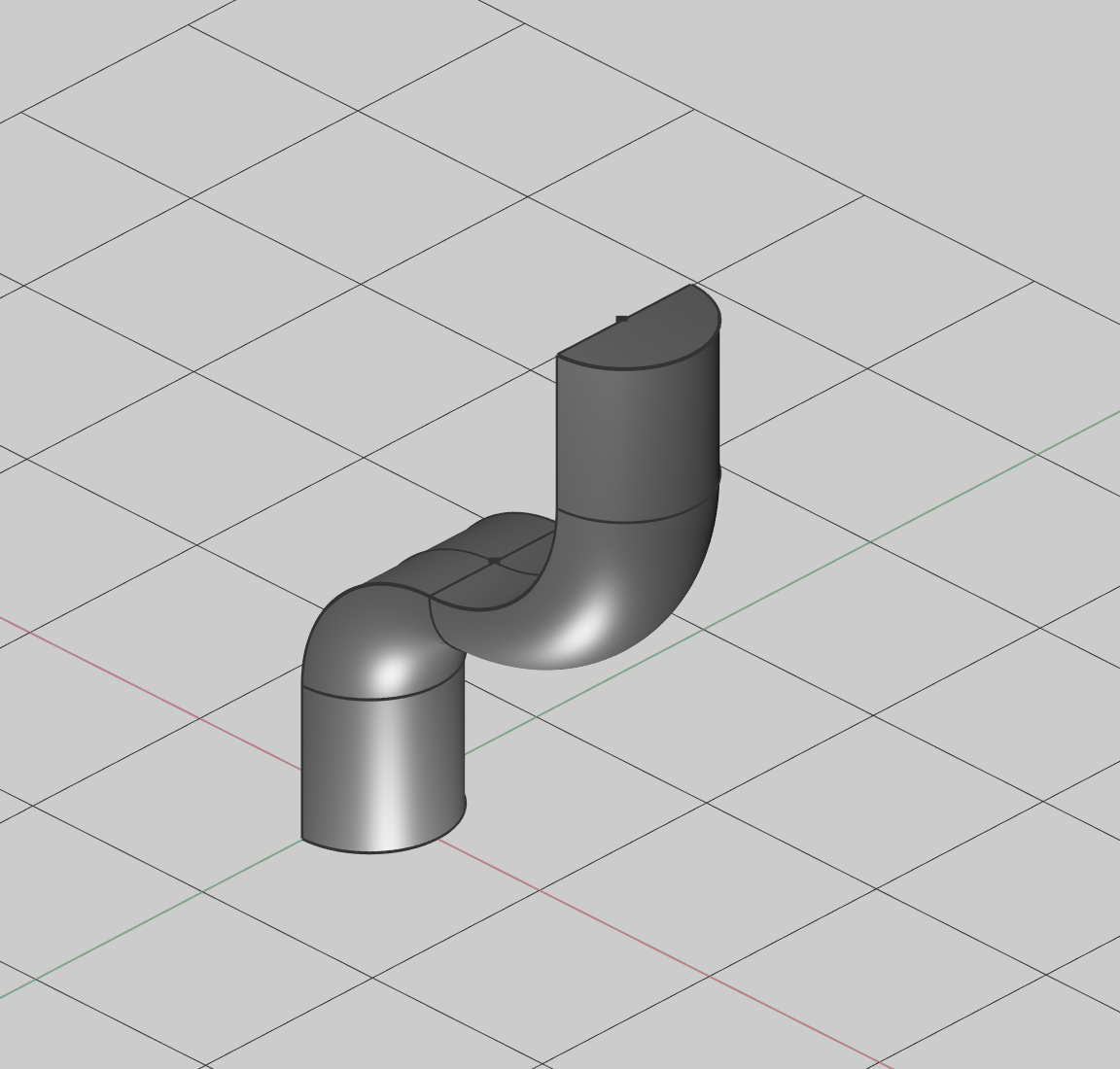

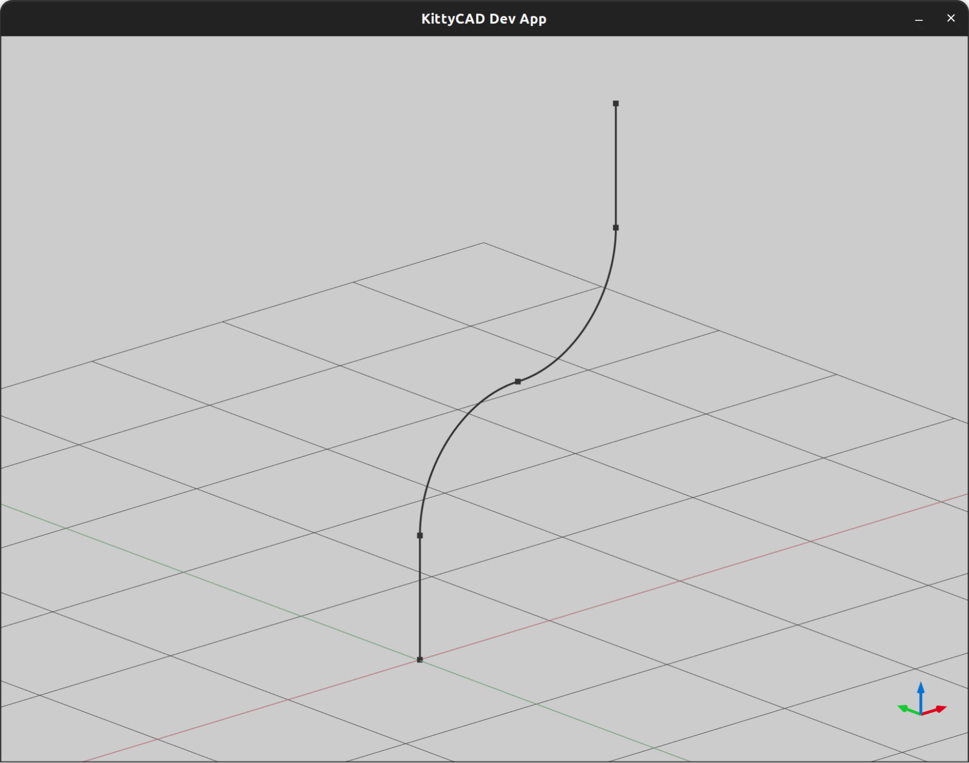

In the case where T(v)T(v) is curved and general, the swept surface can be constructed by a skinned interpolation of cross sections.
This can be described programmatically:

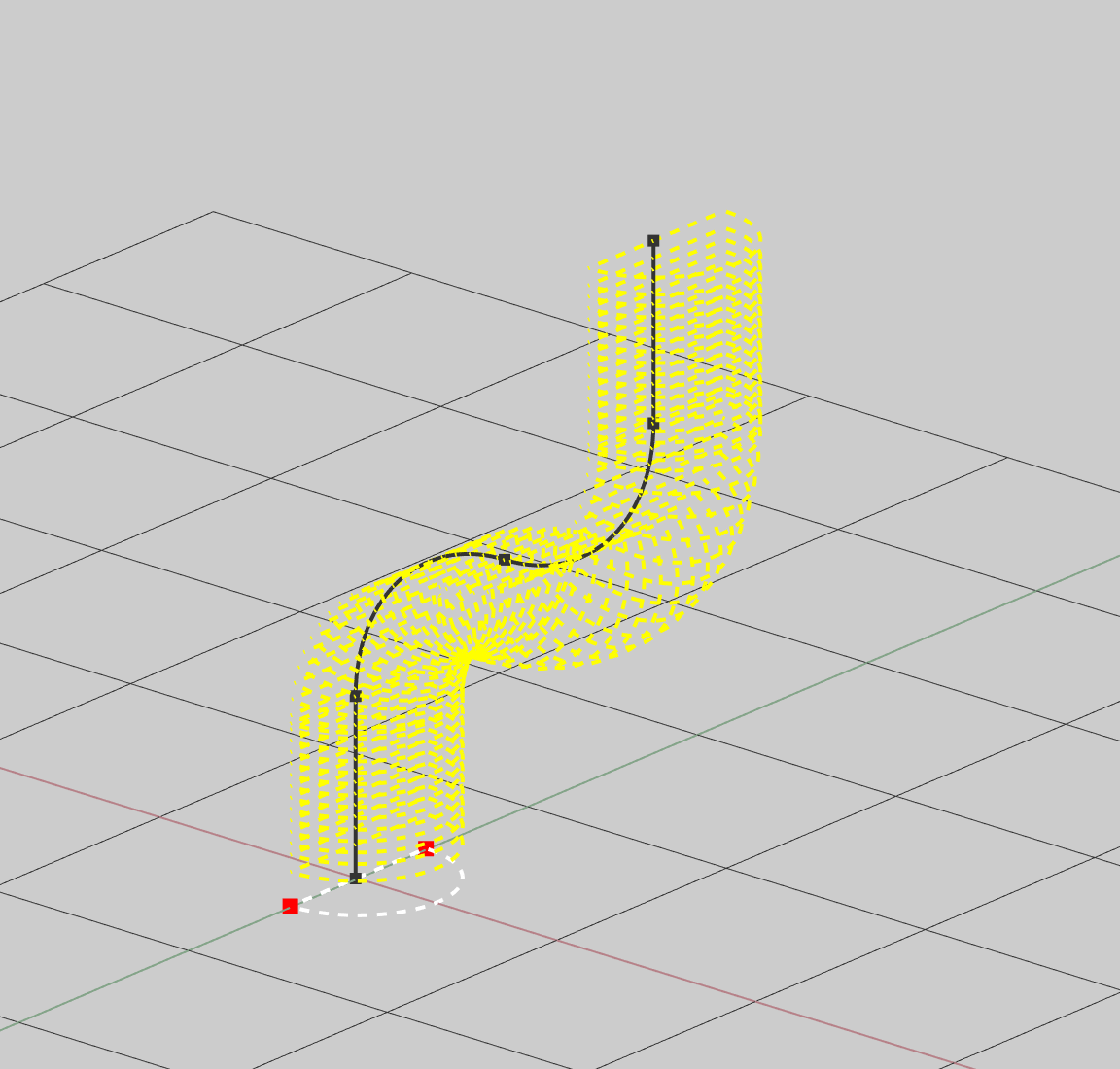

Figure 7 shows the trajectory curve, Figure 8 shows the transformed (re-oriented) section instances, and Figure 9 shows the resulting solid that is yielded by performing a loft operation on the transformed sections.
General Trajectory Curve
Figure 7: General trajectory curve.
Transformed Sections Along Trajectory
Figure 8: Transformed sections along trajectory.
Resulting Swept Solid
Figure 9: Resulting swept solid.

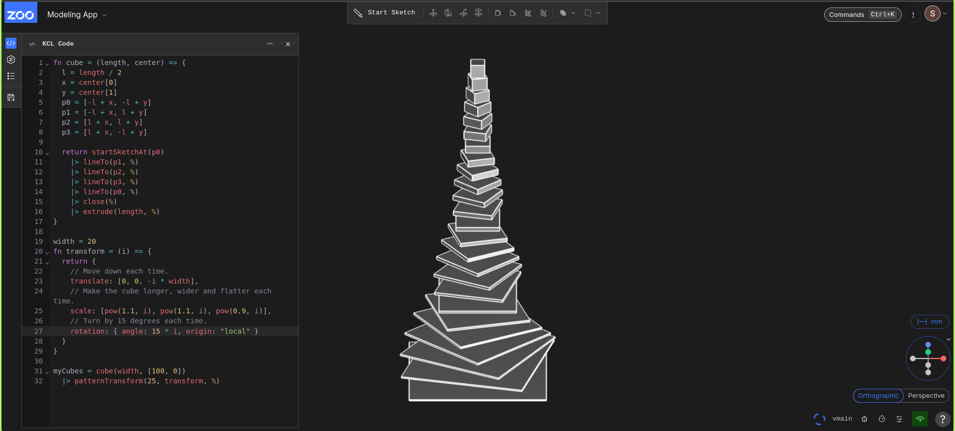

Examples of Patterns
Figure 12: Examples of linear, circular, and array patterns.
It’s not unusual for a mechanical design engineer to want to place many duplicates of an object in a circle, array, line, or otherwise semi-uniform placement. Hand placement is tedious and often inaccurate, hence the need for a more automated way to duplicate geometry uniformly. Since its development, Zoo’s patterns have been highly used and many requests for ways to expand the usage of patterns have been made - they are just that powerful!

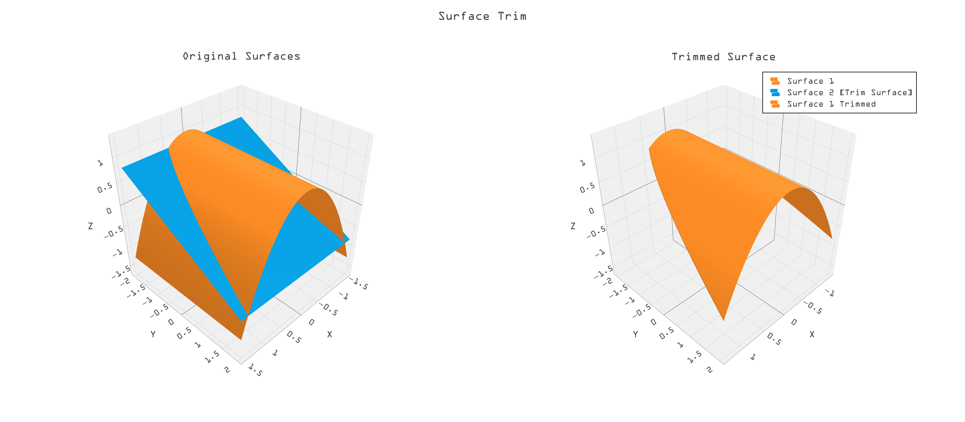

Trimming Example
Figure 16: Trimming.

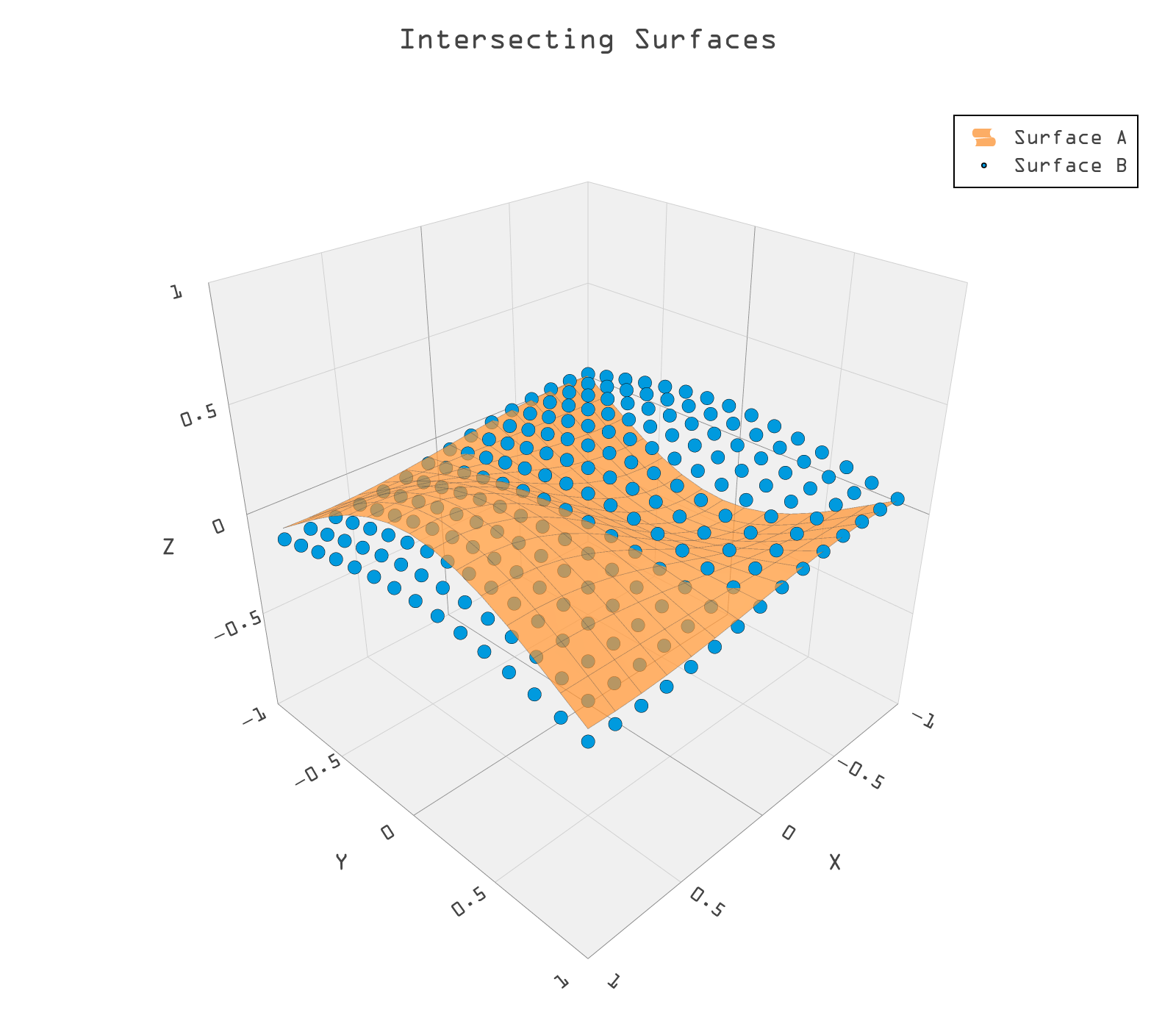

Point Cloud Sampling for SSI
Figure 19: Two intersecting surfaces, one shown as a densely sampled cloud of points.

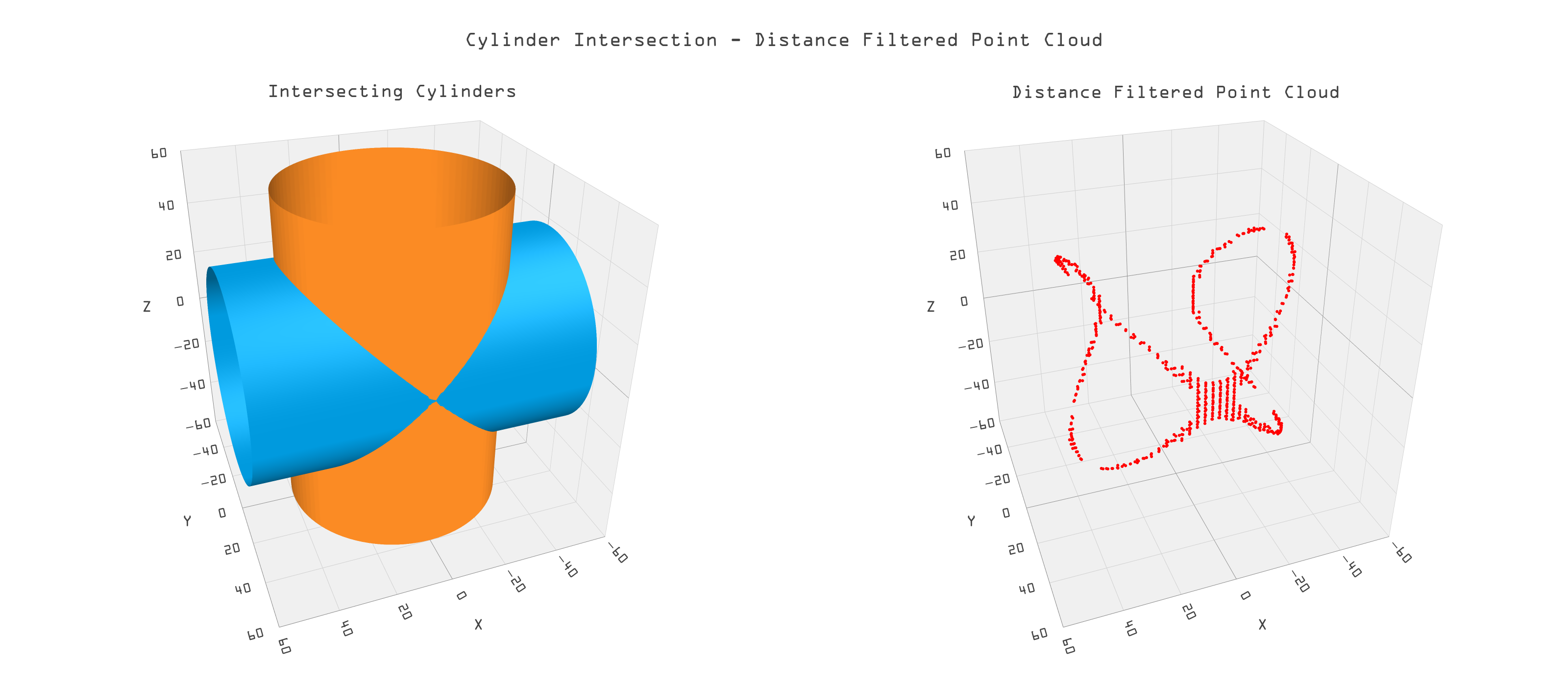

The sample points are generated as 5 tuples, three xyz object space components, and the two associated uv parameters. Figure 20 below shows two cylindrical surfaces juxtaposed at right angles (left). Each cylinder is sampled at 400 by 400 resolution. The SSI is then approximated by the distance filtered point cloud in object space (right). The cloud spreads out where the intersection curves cross on the cylinders because the surfaces lie closer to each other.
Cylinder Intersection Point Cloud
Figure 20: Two cylindrical surfaces and their SSI as points.

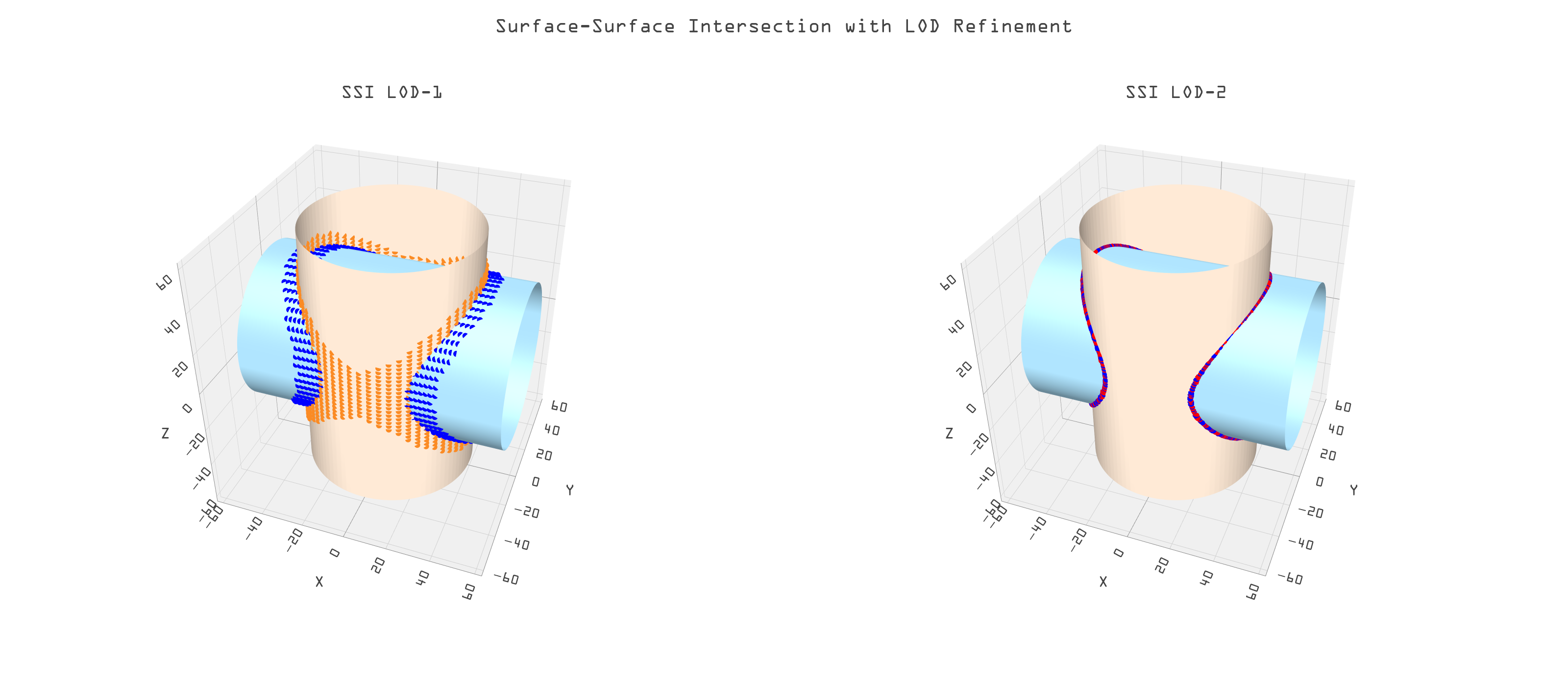

If the resolution of the SSI point cloud is too small (as at the SSI cross), one can simply increase the sample size. A more efficient method, however, is to super-sample and compare distances of pairs in smaller, local neighborhoods around the already calculated SSI points, ie, a level of detail approach (LOD). Smaller subpatches created near the SSI points are far fewer in number than the original sample size. Furthermore, the original resolution can be far smaller since it will be refined in the second stage of LOD.
In the figure below the beginning sample size was 40 by 40, producing the red points. The sub-samples were sampled at 20 by 20, giving an effective sampling density of 800 by 800. The subsequent points near the SSI are displayed in blue for an easy to visualize part of the SSI.
LOD SSI Points for Cylinders
Figure 21: SSI points at two levels of detail for crossed cylinders.

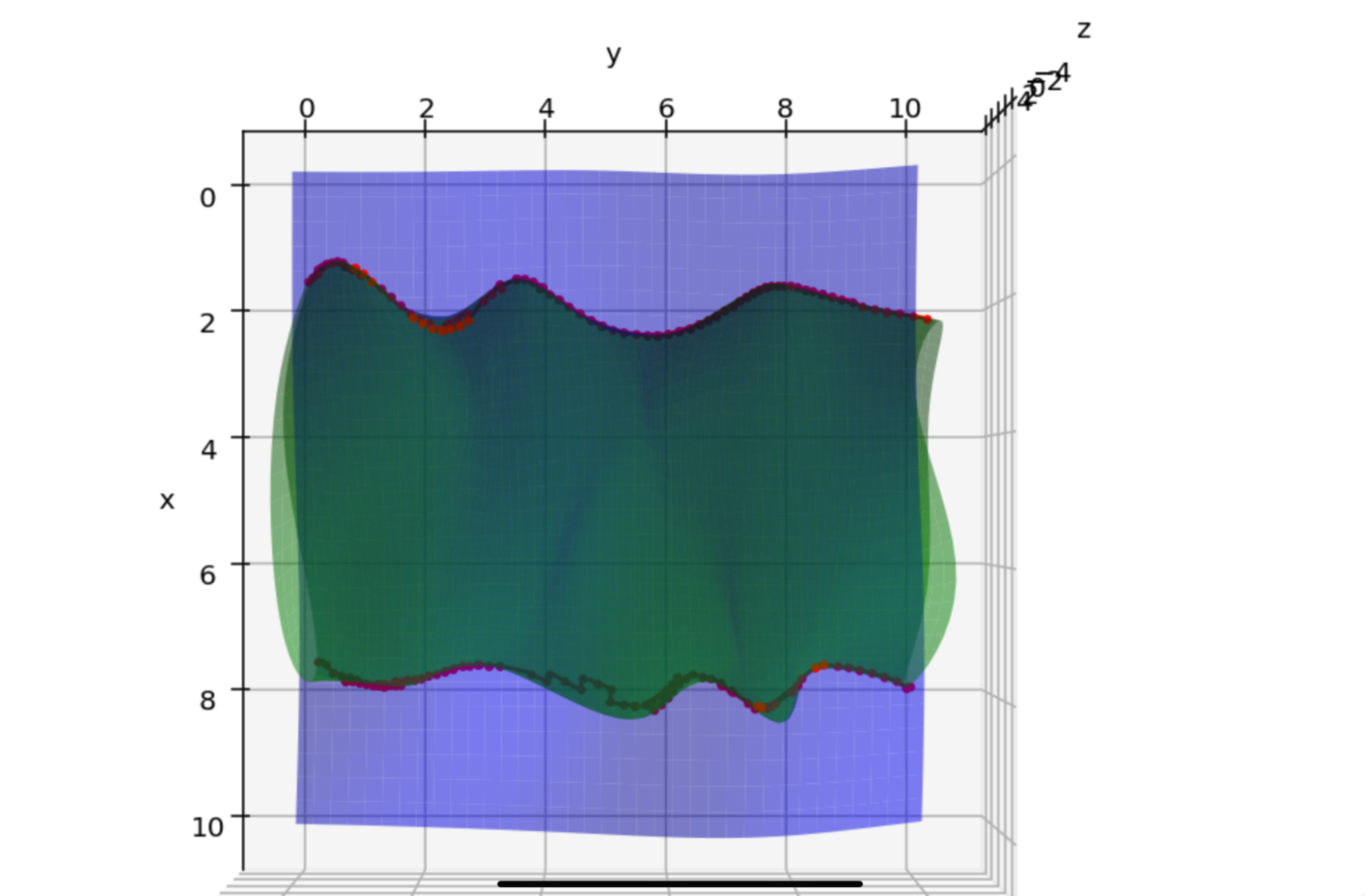

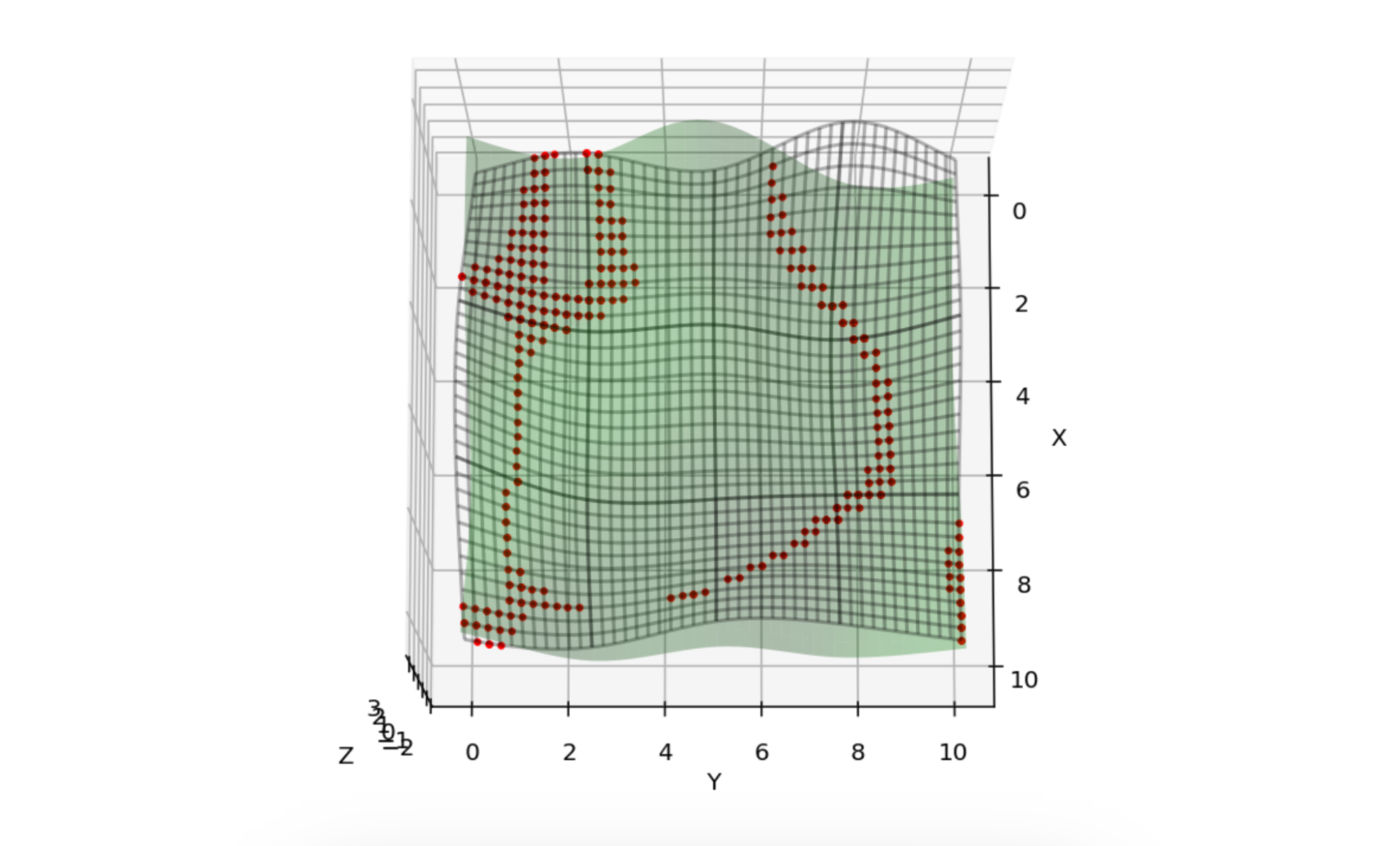

At this point, we have not really made an intersection curve, rather we have a set of unorganized points, which are close to the intersection. We now focus on the uv components of the points in parameter space to do some advanced processing to improve the quality, precision, and usefulness of the SSI curve that we're going to ultimately produce.
Consider the green surface and gridded surface in Figure 22. The latter is gridded for visibility. This is a more complex intersection than we have yet seen. It will help demonstrate why we need to process in parameter space. Figure 23 shows the corresponding 2d uv points in that space.
Complex SSI Points in Object Space
Figure 22: SSI points (red) between green and gridded surfaces.
Complex SSI Points in UV Space
Figure 23: The uv parameter points of the points in Figure 24.

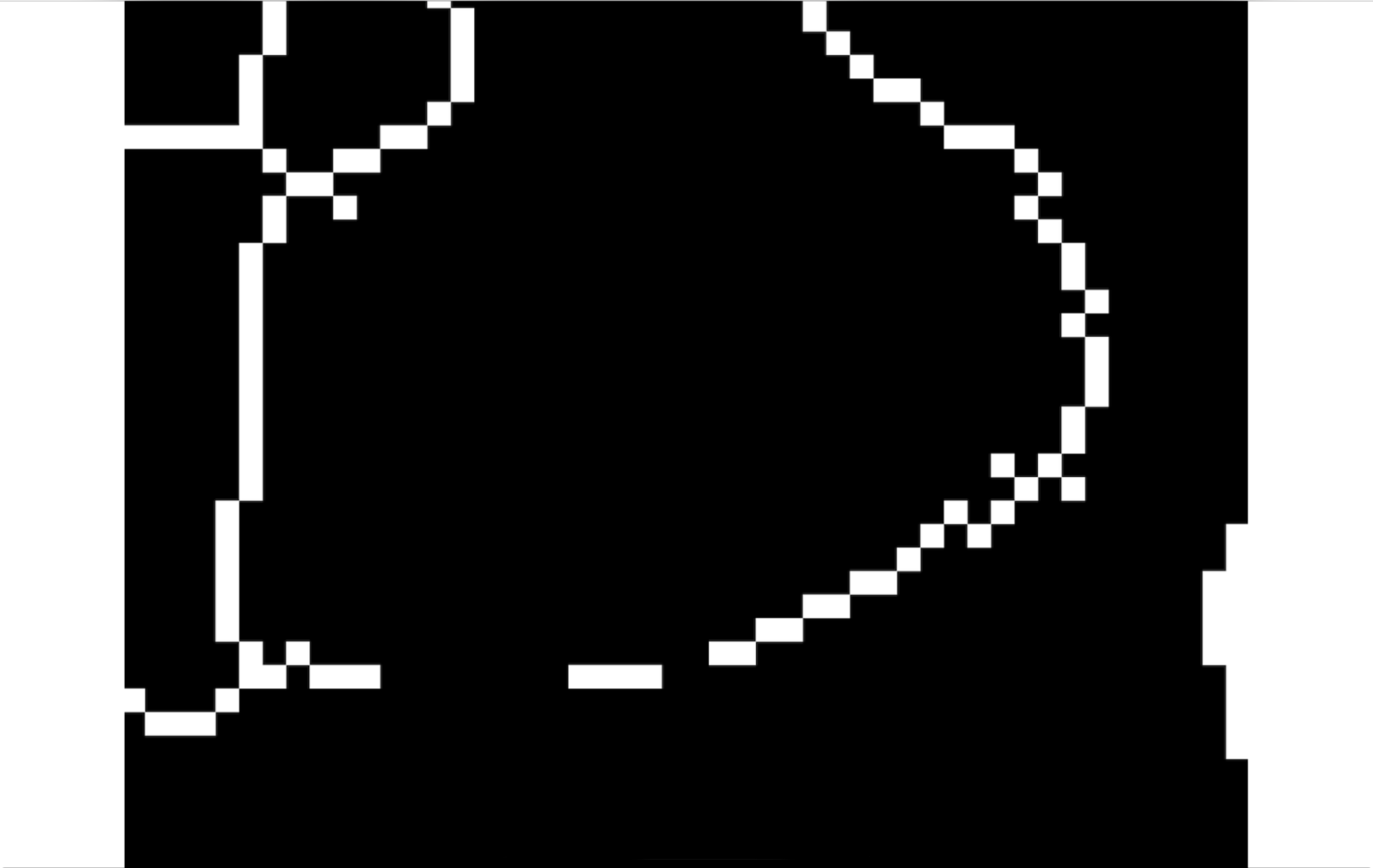

It’s clear from Figure 23 that the thickened areas need to be thinned down to a curve. A number of (image processing) routines exist to do just this such as numpy’s “thinning,” “skeletonize,” or our preferred one, the “medial axis transform” (MAT). Figure 24 is the result of applying MAT to Figure 23.
Medial Axis Transform Result
Figure 24: MAT applied to the point set in Figure 23.

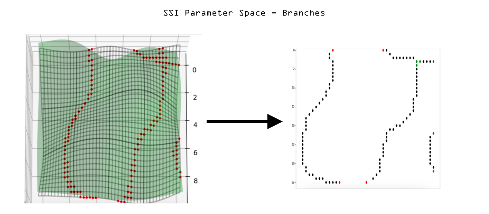

SSI with Classified Points
Figure 25: SSI in object space (left) and parameter space uv-points classified by joints (green), end points (red), and simple branch points (black).

Another option is to create SSI for each surface and then average the result. This should be even more accurate. Many tests are still needed.
Finally, it should be noted that the performance of our routine depends critically on the sampling of the two surfaces. A separate white paper details the research we have done into the evaluation of NURBS using GPUs.
Successful SSI Example
Figure 28. A good SSI is modest, unassuming, and works!
