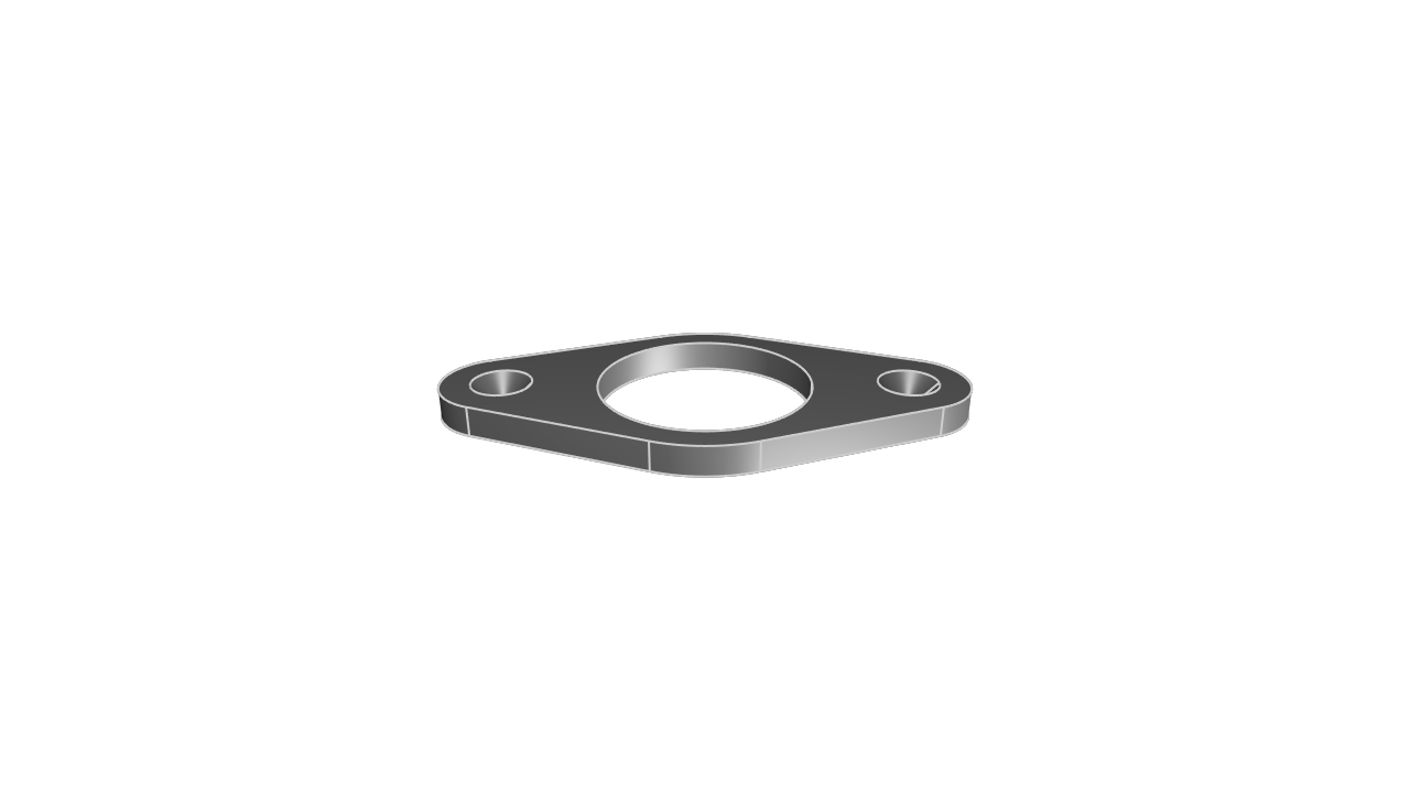

// Plate with countersunk holes
// A small mounting plate with a countersunk hole at each end
// Set units
@settings(defaultLengthUnit = in)
// Define parameters
boltSpacing = 5
boltDiameter = 1 / 4
centerHoleDiameter = 1 + 3 / 4
plateThickness = 0.375
// Check that the plate is thick enough to countersink a hole
// assertGreaterThan(plateThickness, boltDiameter, "This plate is not thick enough for the necessary countersink dimensions")
// A bit of math to calculate the tangent line between the two diameters
r1 = centerHoleDiameter / 2 * 1.5 + .35
r2 = boltDiameter * 2 + .25
d = boltSpacing / 2
tangentAngle = asin((r1 - r2) / d)
tangentLength = (r1 - r2) / tan(tangentAngle)
plateBody = startSketchOn(XY)
  // Use polar coordinates to start the sketch at the tangent point of the larger radius
  |> startProfile(at = polar(angle = 90deg - tangentAngle, length = r1))
  |> angledLine(angle = -tangentAngle, length = tangentLength)
  |> tangentialArc(radius = r2, angle = (tangentAngle - 90deg) * 2)
  |> angledLine(angle = tangentAngle, length = -tangentLength)
  |> tangentialArc(radius = r1, angle = -tangentAngle * 2)
  |> angledLine(angle = -tangentAngle, length = -tangentLength)
  |> angledLine(angle = tangentAngle, length = tangentLength)
  |> tangentialArc(endAbsolute = [profileStartX(%), profileStartY(%)])
  |> subtract2d(tool = circle(center = [0, 0], radius = centerHoleDiameter / 2 * 1.5))
  |> extrude(length = plateThickness)
// Function to create a countersunk hole
fn countersink(@holePosition) {
  startSketchOn(plateBody, face = END)
    |> circle(center = [holePosition, 0], radius = boltDiameter / 2, tag = $hole01)
    |> extrude(length = -plateThickness)
    // Use a chamfer to create a 90-degree countersink
    |> chamfer(length = boltDiameter, tags = [hole01])
  return {  }
// Place a countersunk hole at each bolt hole position
countersink(-boltSpacing / 2)
countersink(boltSpacing / 2)
