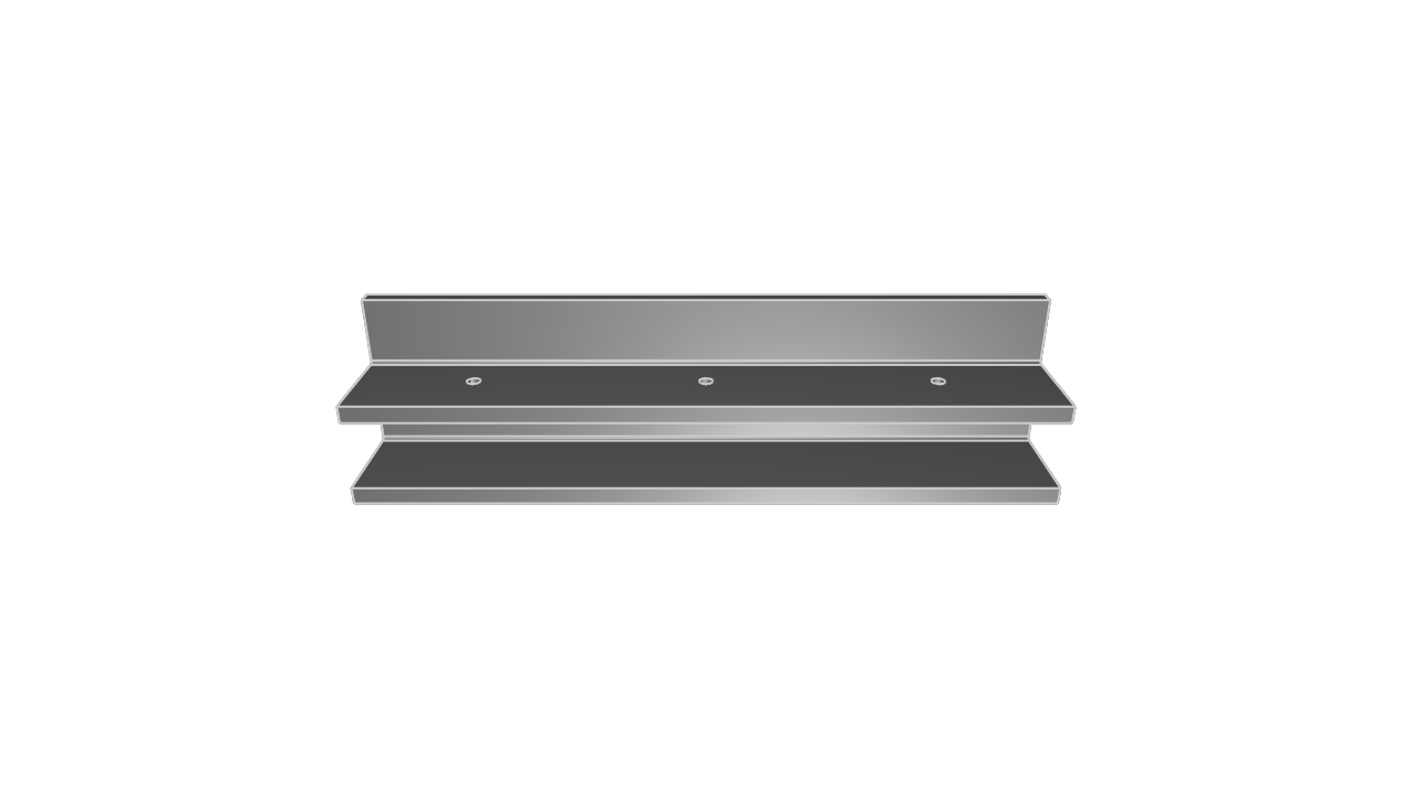

// Desk-Edge Stopper
// 3-D–printable U-shaped guard that slides onto a desk edge and raises a vertical wall to keep pens, phones, cables, etc. from slipping off the tabletop.

// 3D GEOMETRY
// Begin with a 2D sketch of the cross-section. The internal shape comes first, since it must adapt precisely to desk thickness — the rest builds around it. This keeps the model parametric and resilient to design changes.
guardSketch = startSketchOn(YZ)
guardProfile = startProfile(guardSketch, at = [0, 0])
  // Internal shape of the U-profile (bottom and two sides)
  |> xLine(length = uProfileDepthInside, tag = $innerFaceOfTheUProfileLeftSide)
  |> yLine(length = uProfileWidthInside, tag = $innerFaceOfTheUprofileBottom)
  // Upper face of the U-profile — this part rests flat on the tabletop
  |> xLine(length = -uProfileDepthInside, tag = $innerFaceOfTheUprofileRightSide)
  // Thickness of the U-profile walls
  |> yLine(length = materialThickness)
  // Outside side of the upper face of the U-profile — side facing the ceiling
  |> xLine(length = uProfileDepthInside, tag = $upperFaceOfTheUprofile)
  // Height of the border wall
  |> yLine(length = stopWallHeight, tag = $innerFaceOfTheWall)
  |> xLine(length = materialThickness)
  // Front face of the whole guard (wall + u-profile)
  |> yLine(length = -totalGuardHeight)
  // Bottom face of the whole guard (wall + u-profile)
  |> xLine(length = -totalGuardDepth)
  // Close the loop / thickness of the U-profile wall
guardBody = extrude(guardProfile, length = guardLengthAlongDesk)
