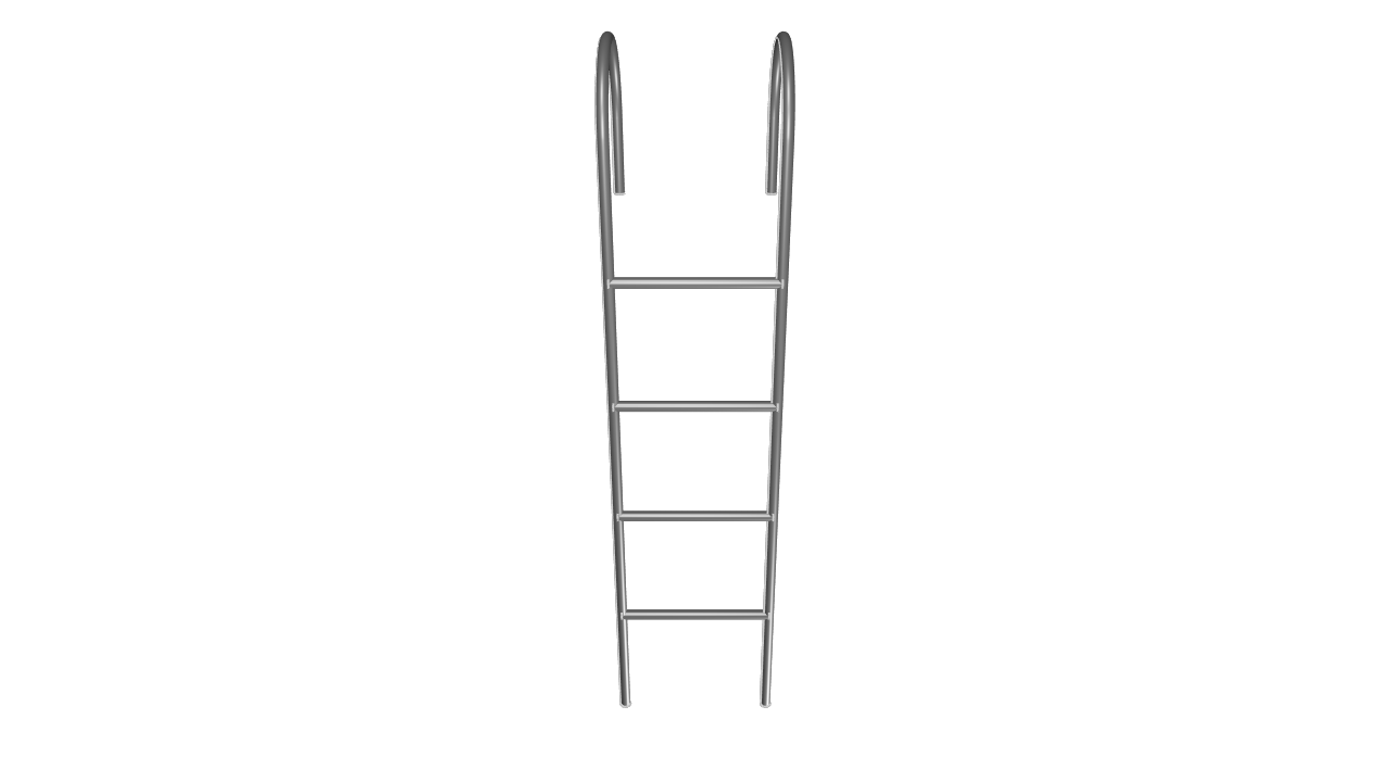

// Marine Ladder
// A parametric vertical or steep-access ladder commonly used on ships, in engine rooms, or in industrial environments. It features two bent side rails and evenly spaced cylindrical rungs for compact, reinforced access.
@settings(defaultLengthUnit = mm, kclVersion = 1.0)
// Ladder Dimensions
ladderHeight = 2000 // vertical height from bottom to top
ladderWidth = 450 // total width from outer edge to outer edge
ladderReach = 450 // horizontal projection of top arc (hook portion)
// Rail Geometry
railDiameter = 30 // outer diameter of the round rails (cylindrical tubes)
// Rung Geometry
rungDiameter = 30 // diameter of each rung (cylindrical)
rungDepth = ladderWidth // span of each rung (same as inner rail spacing)
rungCount = 4 // number of rungs
rungSpacing = (ladderHeight - (ladderReach / 2)) / (rungCount + 1) // vertical step pitch
// Side Rails (swept arcs)
railPath = startSketchOn(YZ)
  |> startProfile(at = [0, 0])
  |> yLine(length = ladderHeight - (ladderReach / 2))
  |> tangentialArc(endAbsolute = [
       ladderReach,
  |> yLine(length = -ladderReach / 2) // vertical tip-down
railSection = startSketchOn(XY)
  |> circle(center = [0, 0], radius = railDiameter / 2)
singleRail = sweep(railSection, path = railPath)
rails = translate(singleRail, x = -ladderWidth / 2)
  |> patternLinear3d(
       instances = 2,
       distance = ladderWidth,
       axis = [1, 0, 0],
// Rungs
rungProfile = offsetPlane(YZ, offset = -ladderWidth / 2)
  |> circle(center = [0, 0], radius = rungDiameter / 2)
singleRung = extrude(rungProfile, length = ladderWidth)
rungs = translate(singleRung, z = rungSpacing)
  |> patternLinear3d(
       instances = rungCount,
       distance = rungSpacing,
       axis = [0, 0, 1],
