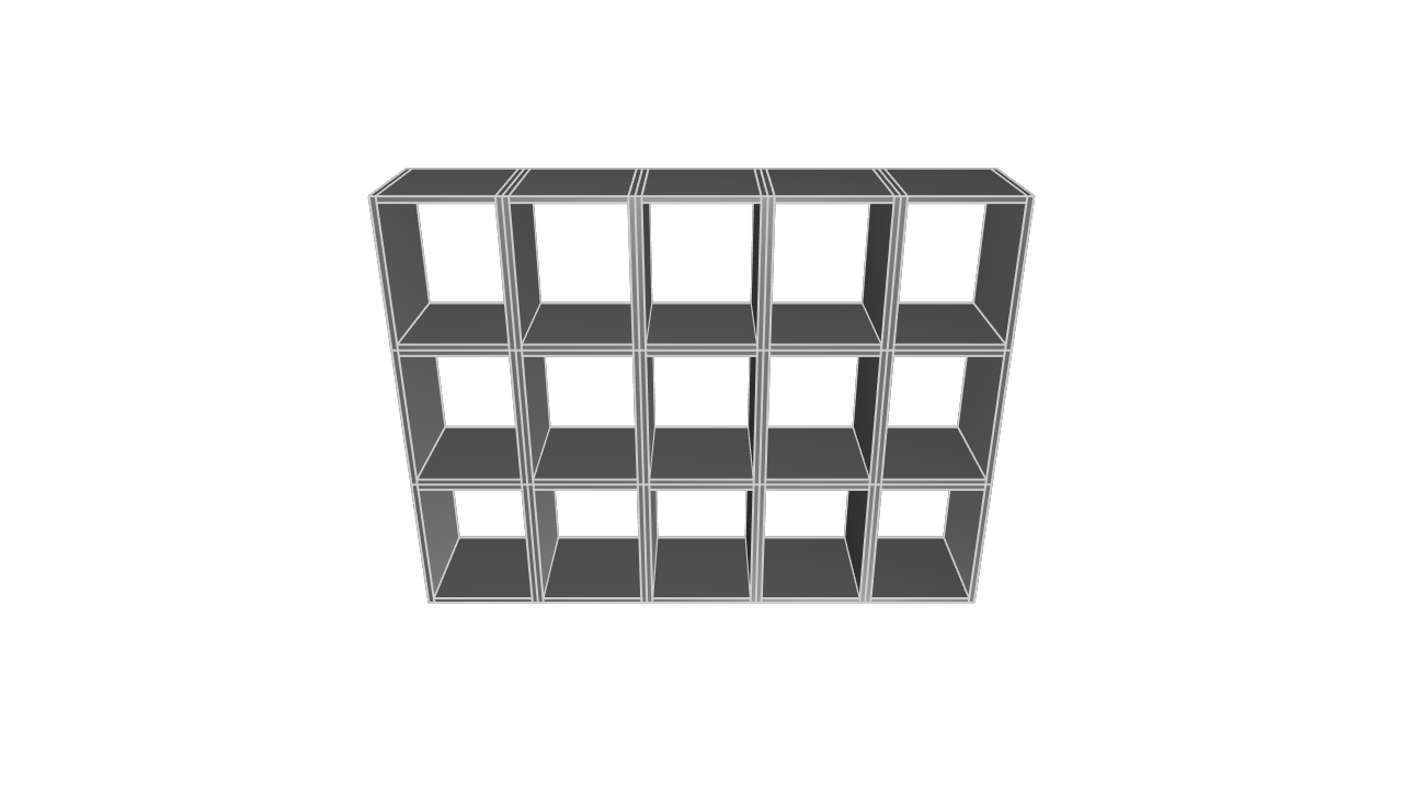

// Modular Shelf Grid
// A parametric, grid-based shelving system for layout prototyping and modular storage design.
// This model generates a configurable number of uniform shelf modules,
// stacked in a grid defined by row and column counts.
// Each module is:
// - A rectangular box composed of two vertical side panels and two horizontal shelves
// - Open at the front for accessible storage
// All dimensions and counts are parametric, enabling rapid iteration
// for uses such as built-ins, modular wall storage, or retail shelving.

// --- Grid of Shelf Modules ---
// Repeats the basic shelf module (side panels + two shelves)
// in both horizontal and vertical directions to form a full grid.
