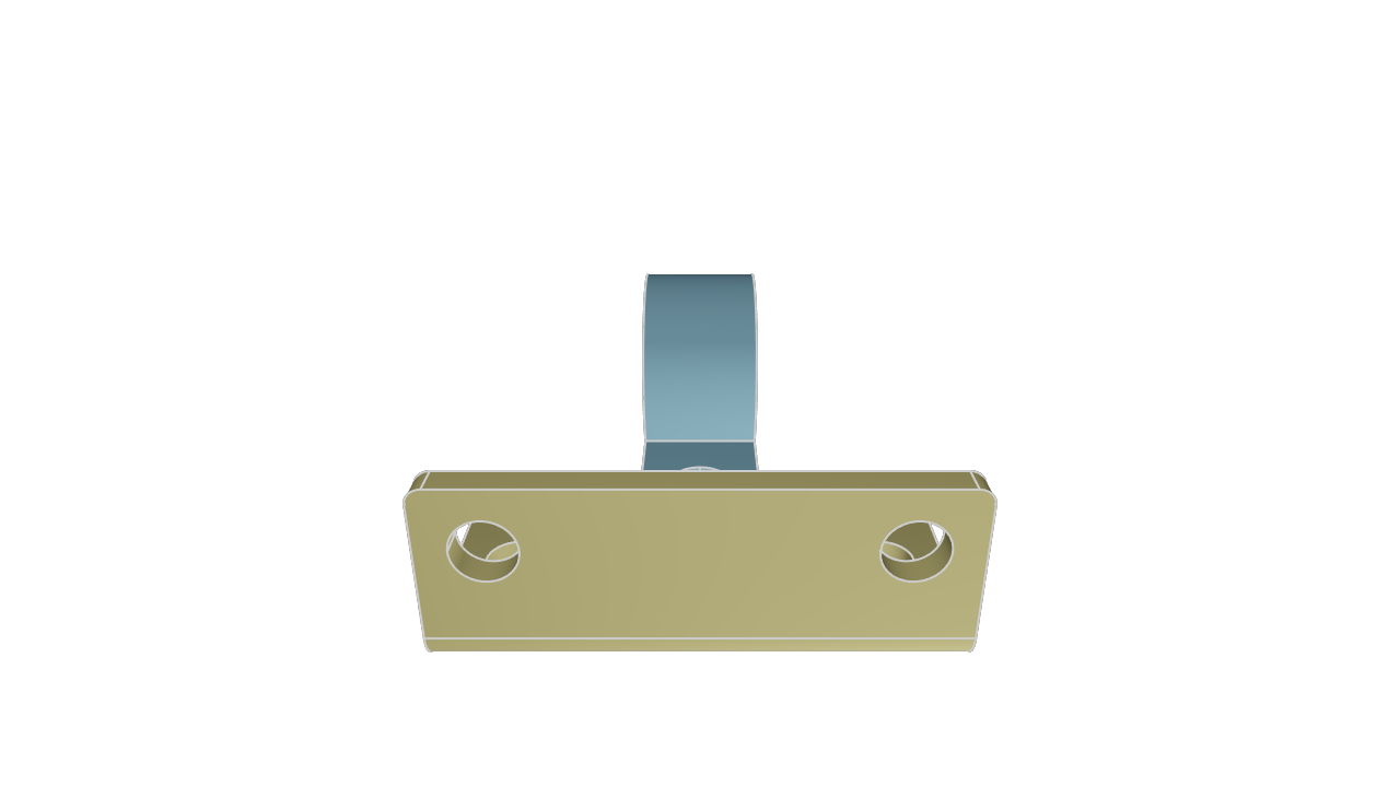

// Propellant Line Bracket
// A propellant line bracket is a mechanical support structure used to secure and stabilize propellant lines in an aerospace vehicle — such as a rocket, spacecraft, or launch platform. These brackets ensure that the fluid lines remain safely in place throughout the vehicle's lifecycle: during assembly, launch, flight, and possibly reentry or landing. These typically come with p-clamps or other types of clamping to secure the tubes.

// Extrude the bracket sketch to make the body. Add fillets to all corners.

// Create mounting holes on the bottom face of the bracket.
sketch002 = startSketchOn(bracketExtrude, face = seg01)
profile002 = circle(sketch002, center = [holeXy[0][0], holeXy[0][1]], radius = holeDiameter / 2)
profile003 = circle(sketch002, center = [holeXy[1][0], holeXy[1][1]], radius = holeDiameter / 2)
profile004 = circle(sketch002, center = [holeXy[2][0], holeXy[2][1]], radius = holeDiameter / 2)
bottomHoles = extrude([profile002, profile003, profile004], length = -.25)
// Create the mounting holes on the side face of the bracket.
sketch003 = startSketchOn(bracketExtrude, face = seg02)
profile005 = circle(sketch003, center = [-.5, 1], radius = holeDiameter / 2)
profile006 = circle(sketch003, center = [-bracketLength + .5, 1], radius = holeDiameter / 2)
extrude001 = extrude([profile006, profile005], length = -.25)
  |> appearance(%, color = "#a18e30")
