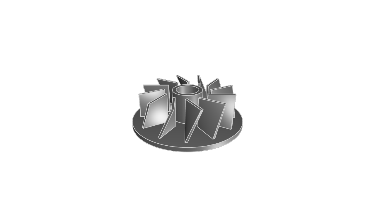

// Impeller (Radial-flow)
// Radial-flow impeller for centrifugal pumps—designed as a parametric base for blade and housing experiments.

// loft one curved blade
oneBlade = loft([leadRect, trailRect])
