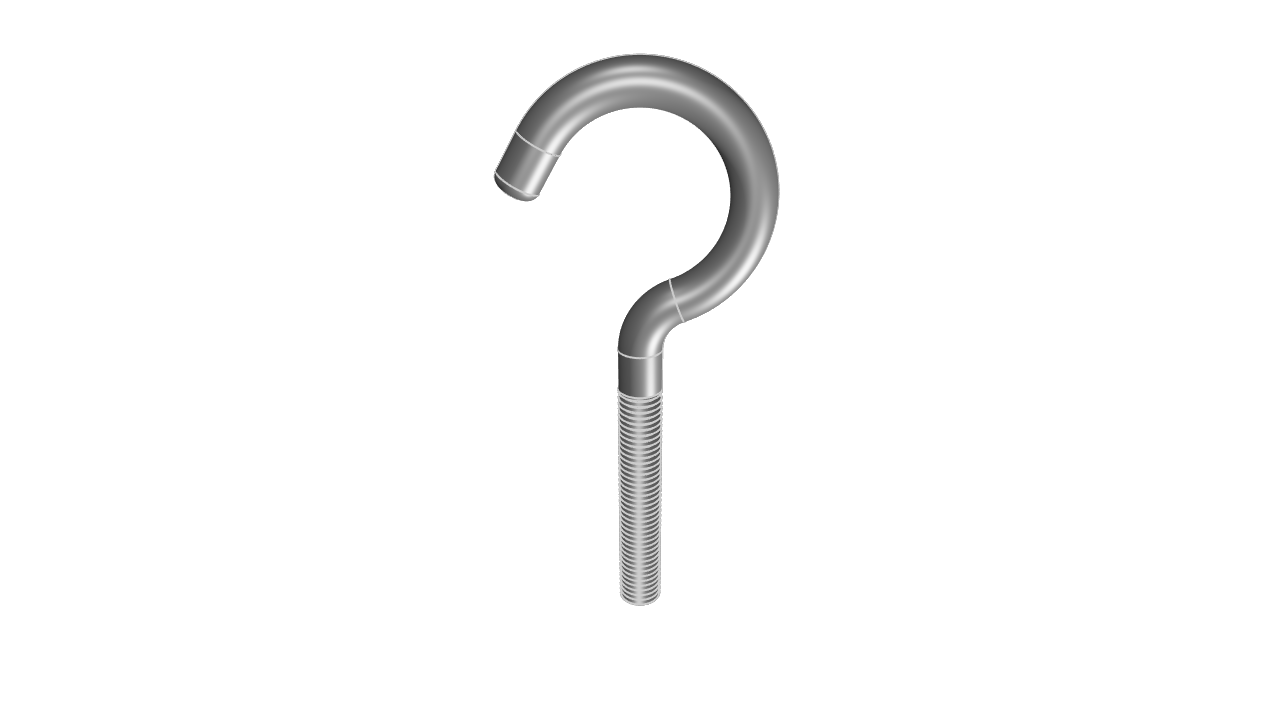

// Shepherd’s Hook Bolt
// A bent bolt with a curved hook, typically used for hanging or anchoring loads. The threaded end allows secure attachment to surfaces or materials, while the curved hook resists pull-out under tension.
