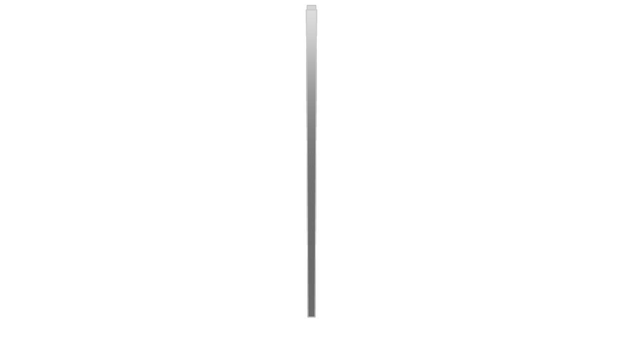

// Straight Rung Ladder
// A basic parametric ladder model with two side rails and evenly spaced rungs. Designed for use in architectural layouts, equipment modeling, or marine/industrial planning.
@settings(defaultLengthUnit = mm, kclVersion = 1.0)
// --- Dimensions ---
ladderHeight = 2000 // total height of the ladder
ladderWidth = 400 // width between outer edges of side rails
railDepth = 50 // depth of the side rails
railThickness = 30 // thickness of the side rails (front to back)
rungLength = ladderWidth - (railThickness * 2) // horizontal span between rails
rungHeight = 20 // height of each rung (rectangle)
rungDepth = 30 // extrusion depth of each rung
rungCount = 5 // number of rungs
rungSpacing = ladderHeight / (rungCount + 1) // vertical spacing between rungs
