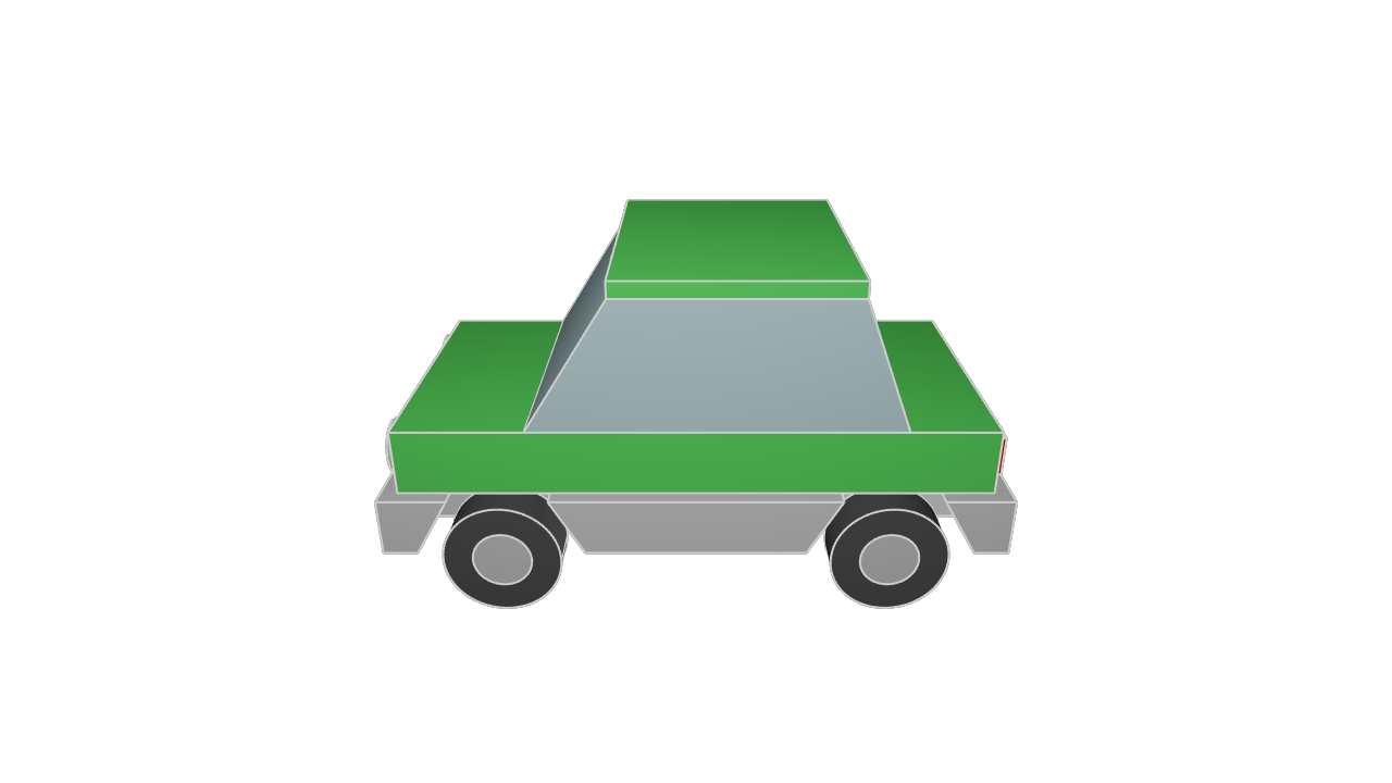

// Stylized Car
// A simplified, parametric 3-D model of a small car intended for use as a low-poly prop in real-time engines, visualization scenes, or rapid prototyping.
// The model includes:
// - A chassis block forming the vehicle’s base
// - Front and rear fenders with wheel cut-outs
// - Four detachable wheels (tire + hubcap)
// - A cabin with sloped windshield and rear panel
// - A thin roof slab
// - Circular headlights and rectangular taillights
// All major dimensions are parameterized for quick adjustments.
// Geometry prioritizes clarity and clean topology over realism, making it ideal
// for game assets, placeholder art, or visual-scripting demos.
