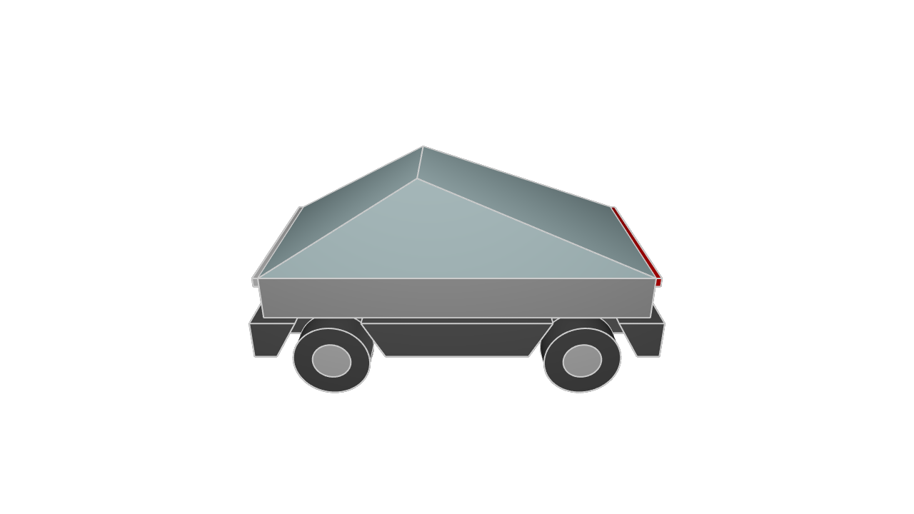

// Stylized Cybertruck
// A simplified, parametric 3-D model of a low-poly cybertruck, intended for use as a game-ready asset, concept visualization, or real-time rendering demo.
// The model includes:
// - A chassis block forming the vehicle’s base
// - Front and rear fenders with wheel cut-outs
// - Four detachable wheels (tire + hubcap)
// - An angular cabin defined by intersecting trapezoids
// - Sloped front, rear, and side panels
// - Flat front and rear light panels
// All major dimensions are parameterized for quick adjustments.
// Geometry prioritizes stylized clarity and clean topology over realism,
// making it suitable for games, educational tools, or prototyping environments.

  // Headlights
// Two circular front lights mounted on the front face of the chassis.
headlightsPlane = offsetPlane(YZ, offset = -chassisLength / 2)
headlightsSketch = startSketchOn(headlightsPlane)
headlightsProfile = startProfile(headlightsSketch, at = [-chassisWidth / 2, headlightsElevation])
  |> yLine(length = -headlightsHeight)
  |> xLine(length = headlightsWidth)
  |> yLine(length = headlightsHeight)
headlightsBody = extrude(headlightsProfile, length = -lightDepth)
  |> appearance(%, color = "#ededed")
  // Taillights
// Two rectangular rear lights mounted on the back face of the chassis.
taillightsPlane = offsetPlane(YZ, offset = chassisLength / 2)
taillightsSketch = startSketchOn(taillightsPlane)
taillightsProfile = startProfile(taillightsSketch, at = [-chassisWidth / 2, taillightsElevation])
  |> yLine(length = -taillightsHeight)
  |> xLine(length = taillightsWidth)
  |> yLine(length = taillightsHeight)
taillightsBody = extrude(taillightsProfile, length = lightDepth)
  |> appearance(%, color = "#ff0000")
