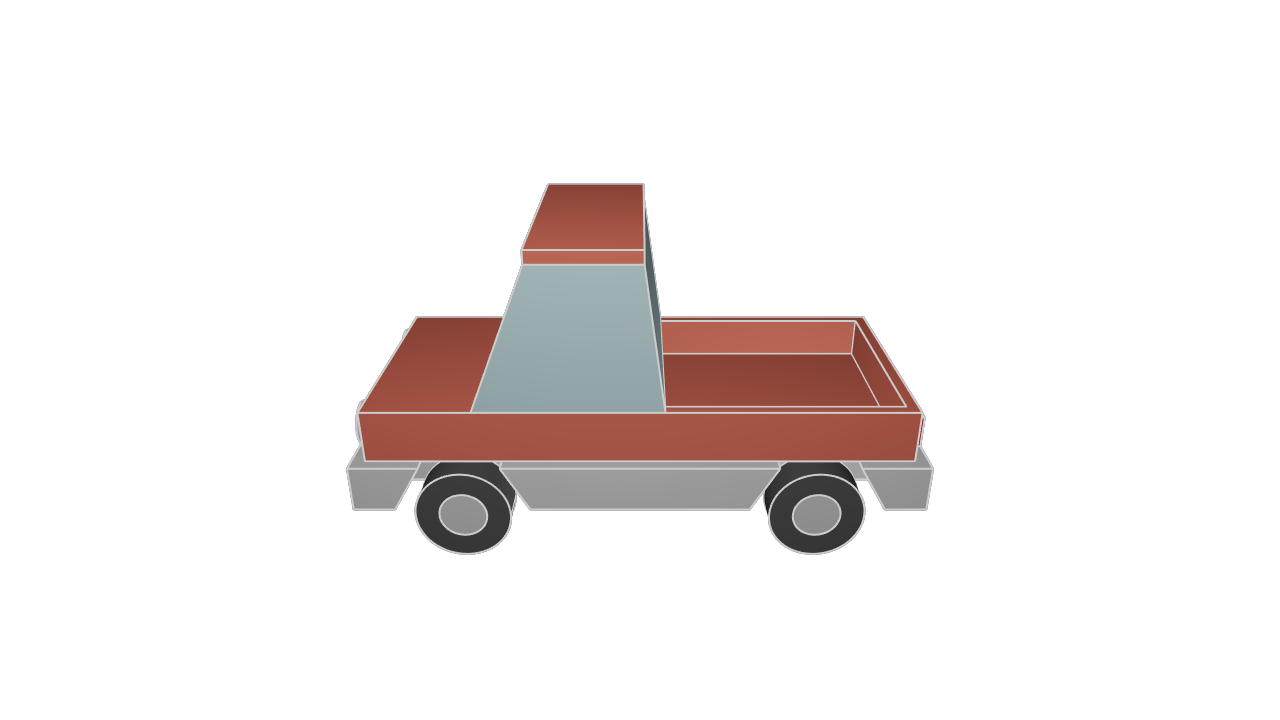

// Stylized Pickup Truck
// A simplified, parametric 3-D model of a pickup truck intended for use as a low-poly prop in real-time engines, visualization scenes, or rapid prototyping.
// The model includes:
// - A chassis block forming the vehicle’s base
// - Front and rear fenders with wheel cut-outs
// - Four detachable wheels (tire + hubcap)
// - A cabin with sloped windshield and rear panel
// - A thin roof slab
// - A recessed cargo bed cut into the chassis
// - Circular headlights and rectangular taillights
// All major dimensions are parameterized for quick adjustments.
// Geometry prioritizes clarity and clean topology over realism, making it ideal
// for game assets, placeholder art, or visual-scripting demos.

// Reference planes
chassisPlane = offsetPlane(XZ, offset = chassisWidth / 2) // profile plane for chassis and cabin
fenderPlane = offsetPlane(XZ, offset = chassisWidth / 2 + fenderInset) // profile plane for outer fenders
// Fenders
// Protective side covers that house the wheels.

  // Chassis
  // The main structural body of the vehicle, sitting above the fenders.
// Defines the base frame on which the cabin, roof, and bed are mounted.
chassisProfile = startProfile(chassisPlane, at = [-chassisLength / 2, chassisElevation])

// Cabin (driver/passenger area)
// Enclosed compartment where the driver and passenger sit.
// Has a sloped windshield and back for a stylized look.
cabinSideProfile = startProfile(

  // Wheels
  // Cylindrical wheels with a central hubcap detail.
// Created as separate parts and positioned under the fender cutouts.
fn wheelFn(diameter, width) {
