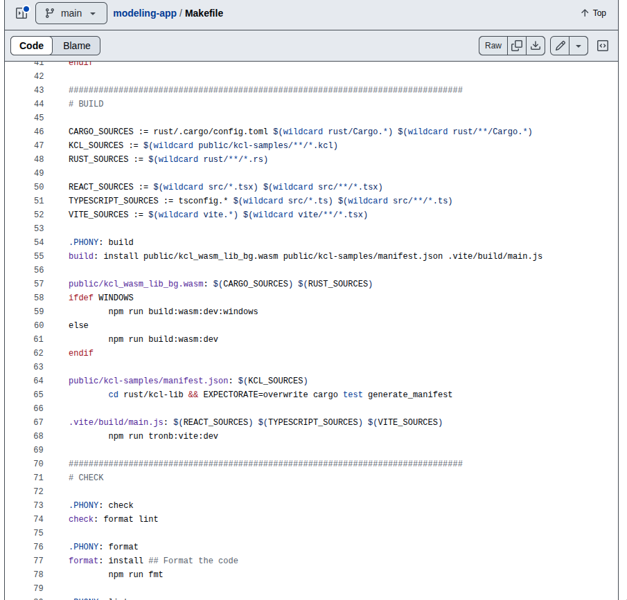

As soon as I opened our project's Makefile, it became crystal clear just how compatible Markdown could be with Makefiles, partially thanks to how Jace wrote it:
design studio's Makefile
Oh my god, a Makefile comment looks just like a Markdown header!

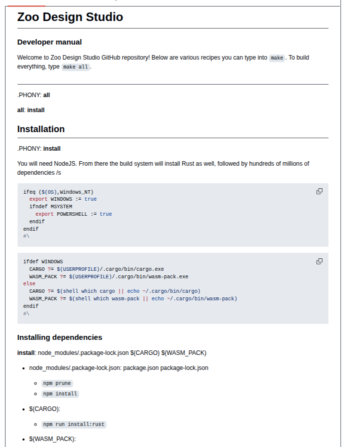

To take advantage of GitHub rendering README.md by default, I deleted our original one and symlinked the Makefile as the README.md to see how it'd render with zero changes.
rm README.md
ln -s Makefile README.md
git add README.md
git commit -m "let's go"
git push
the immediate result with no changes
The result is interesting! But not digestible. The universe. demands. better.

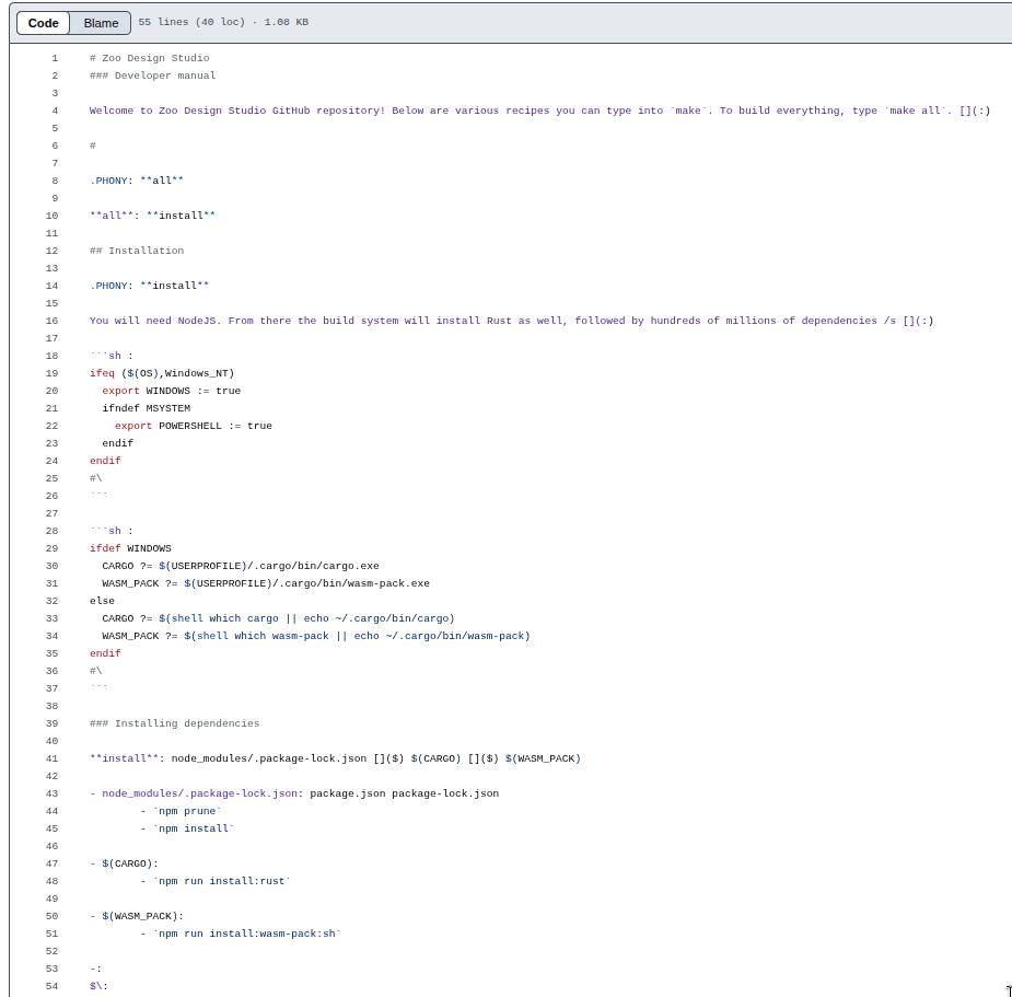

The next styling I decided to do was, unintuitively, code-blocks, because we had ifdefs in our Makefile that I couldn't imagine looking any better than as regular code. Using the reasoning above I was quickly able to find a working combination:
working code-blocks
(Not looking too bad already!)
```sh :
echo "hello world"
There is one issue with this: it always leaves a trailing #\. I was happy though and left it at that. Code-blocks were particularly hard because Markdown demanded that the 3 backticks stood alone on their own line, but Makefile was not happy, always complaining about a missing separator, but we cannot use a separator due to what we just said.
To get around this, we are lucky Makefile supports what I'm going to call "line-folding", where \ is used to collapse two lines. See where we're going with this? We collapse a comment # and the 3 backticks with \ to keep Makefile happy while rendering the code-block. Phew!
Another noteworthy, interesting addition, is the abuse of Makefile's separator : to start the code-block. In Makefile's eyes, we are defining a no-op recipe, which reads "for the recipe \``sh`, do nothing". Perfect for us! In the Markdown rendering, it's completely hidden.
