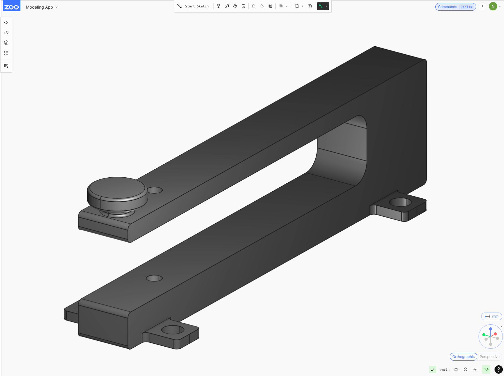

The mechanical bit
This project is a bit 'Mickey Mouse' from a mechanical perspective: it's a single part, 3D printed, subject to basically no load. The actual geometry of the part that I ended up hooking up to the Arduino is shown below, complete with the sort of external corner radii that were broadly illegal when I was designing things that had to be machined.
morse-key
But before I got there via some rapid (and undocumented) iteration, I did actually work through a proper design process, and I have written up both the design work and experimental validation of this thing. In both cases, that documentation follows what I think is a good basis for a document-centric engineering workflow.

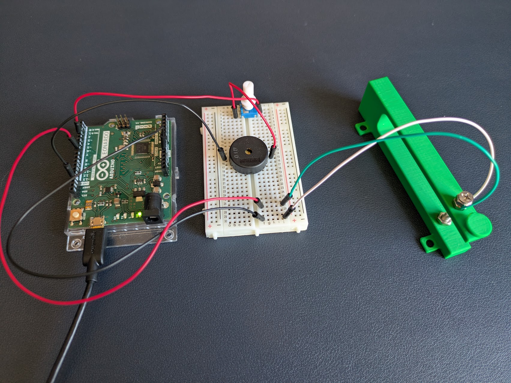

The microcontroller aspect was pretty straightforward. I just needed to detect a closed circuit when the key was pressed, then come up with some mechanism for differentiating dots from dashes.
Wanting to structure the code in a somewhat flexible way, I went with PlatformIO and VSCode over the Arduino IDE, and settled on a project layout like this:
The body of the logic is handled by the MorseTranslator class, which handles the closed circuit detection and the translation of the signal into a keystroke. The other files really just exist to support that; defining parameters and controlling the onboard LED.
In terms of how it actually works:
  • The Morse key's contacts are connected to a digital input pin.
  • When the key is pressed, the pin is pulled low, and current time recorded.
  • When the key is released, the duration is compared to a threshold to classify it as either a dot or a dash.
  • Each dot or dash is appended to a buffer, which represents a single Morse character.
  • After a short gap, the buffer is matched against a lookup table and the corresponding character is written out as a keystroke using Keyboard.write().
We also have a buzzer that beeps when the key is pressed, and an LED that both blinks to indicate the program is running, and lights up when the key is pressed.
The parameterisation, given in constants.h, is as follows:
The full code is also available in the project-morse-key repo.
As assembled, including electrical war crimes, this is what it looked like:
morse-key-assembled
In the video, the HI message is being sent into Notepad, so you can actually (sort of) use it as an input device.
