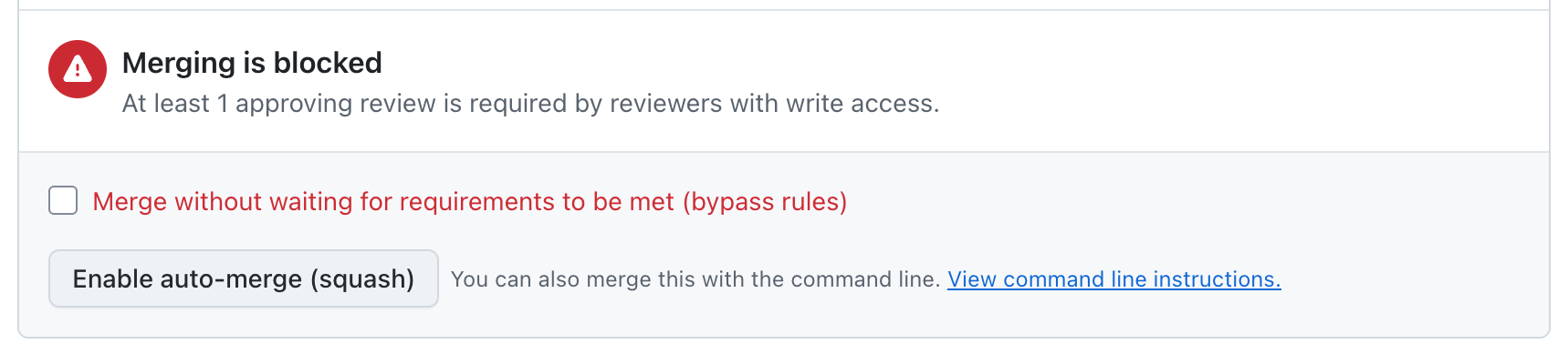

Reviews and GitHub rulesets. Our SOC 2 controls require us to have a formal review process in place for code changes. We already had branch protection rules in place, but those are not flexible or centralized. We also wanted a way to supervise changes performed by administrators. Organization or repository admins can edit branch protection rules and bypass protections. This might even be necessary in emergency situations. We were looking for a technical solution to supervise merges and bypasses.
Since 2023, GitHub has provided rulesets and has been adding features since then. Rulesets allow you to define organization- or enterprise-wide rules for repositories, branches, tags, or pushes. The neat thing is that you can define who can bypass the rulesets, and GitHub also provides an API to fetch rule violations.
We use the API to alert the security team in case someone performs an emergency merge, so we can follow up with reviews. Not everybody on the team can do rule bypasses, but enough can that we and our auditors saw the need for a technical control.
You probably know the "Merging is blocked" message on GitHub. With our setup, you may bypass rules and deal with the consequences. If you are only bypassing due to a failed test, then the security team is alerted, but no further action is required. If you bypass without a review, with our configuration, you are expected to explain yourself, raise an incident ticket, and document the reason for the bypass.
We open-sourced the implementation of our ruleset policy bot. If you find yourself in the same need, feel free to grab it! Originally, were inspired by Tailscale's ToBeReviewedBot which is also open-source! So feel free to check out their approach as well.
