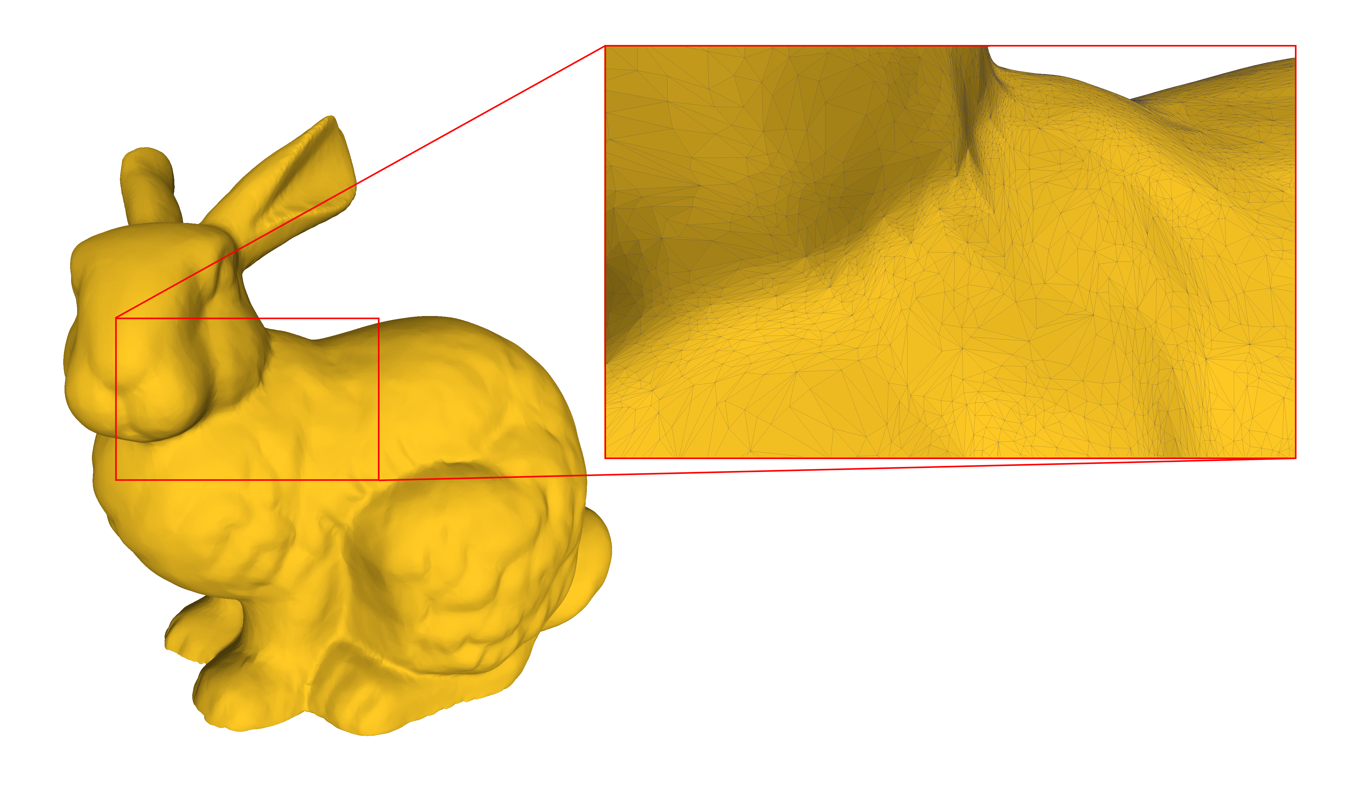

These kinds of formats are almost exclusively based on polygonal meshes. With enough polygons, and with the observer suitably far away, mesh representations of smooth shapes will indeed appear smooth. This is, however, merely an illusion; zooming in will reveal the faceted surface.
Figure 1: Stanford Bunny With Faceted Surface Highlighting

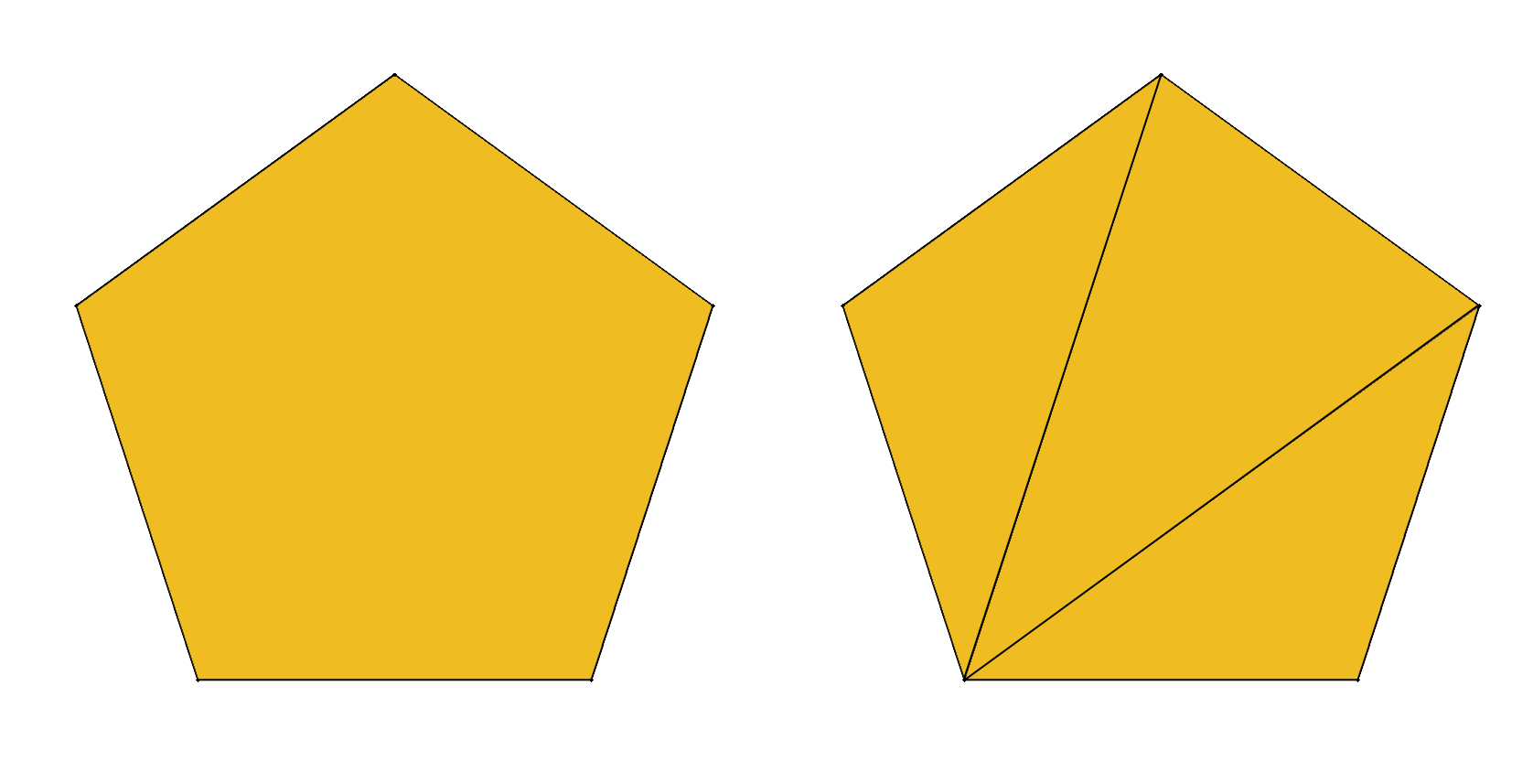

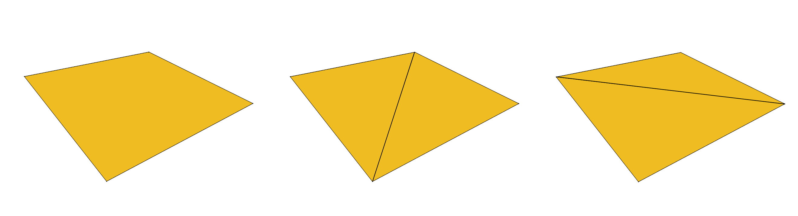

The most common choice of polygon is the triangle. This is because a triangle sits in a plane unambiguously. The same cannot be said about quadrilaterals since they can have two possible ‘bend’ configurations if their four points do not lie in a plane.
Figure 2: Non-Planar Quadrilateral and Its Two Possible Triangulations
The minimal amount of information required to represent a mesh is an ordered set of points plus a rule to connect them together into polygons. The most common rules are triangle lists, triangle strips, and triangle fans.

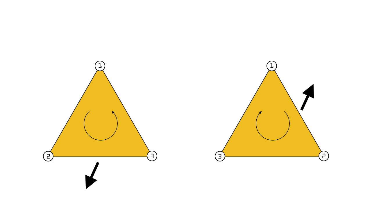

The first approach, triangle lists, is often preferred because it maintains a consistent winding order. The winding order is often used in CAD applications to determine whether a polygon is facing toward or away from its observer.
Figure 3: Winding Order of Front-Facing (Left) Versus Rear-Facing (Right) Triangles

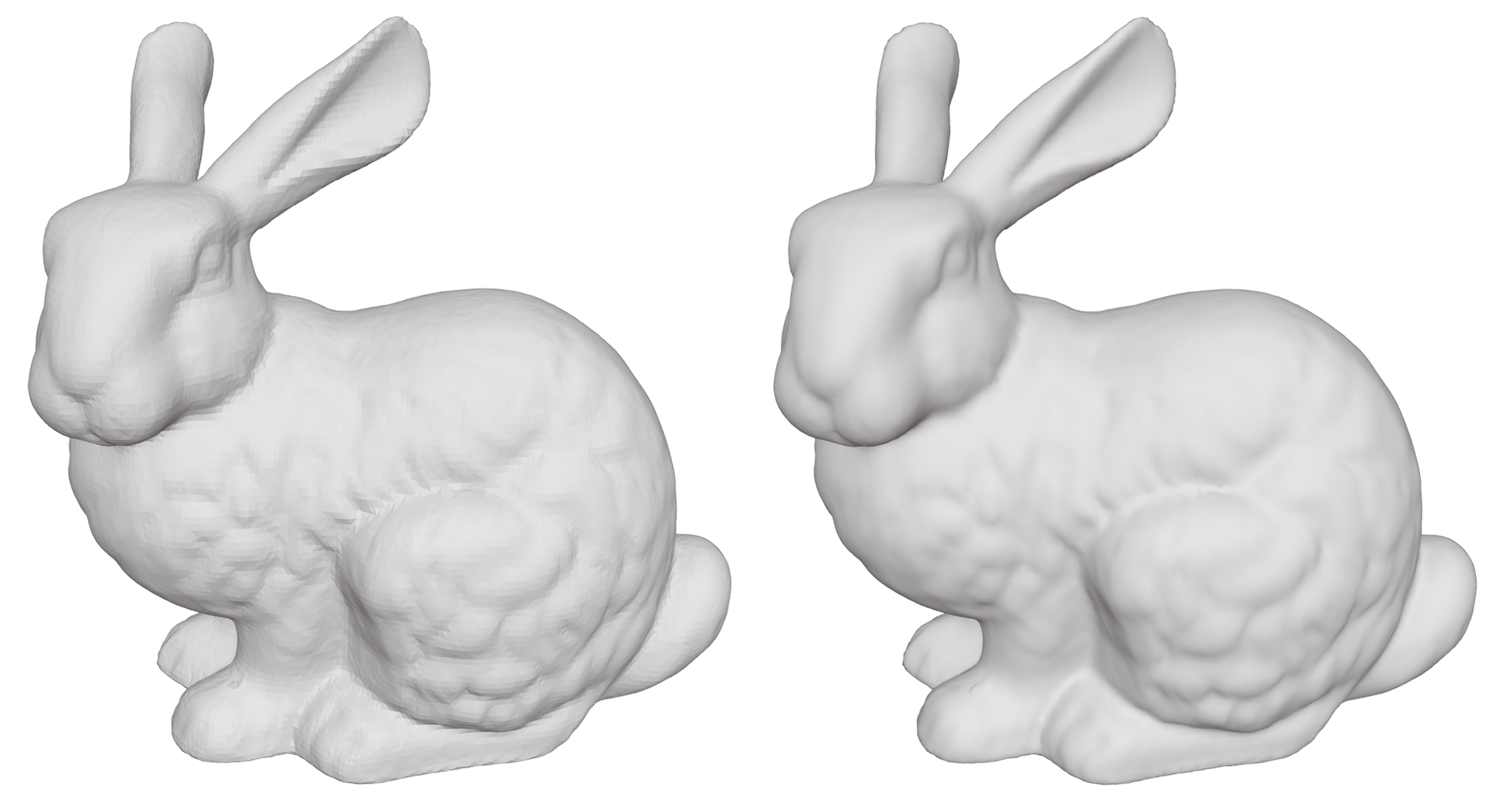

On a planar surface, such as a single triangle, the surface normal vector points in the facing direction directly ‘away’ from the surface. The same is also true for non-planar surfaces but its normal vector varies as the surface curves. 3D renderers can use surface normals to compute lighting per-face; however, this draws attention to the model’s facets, removing the illusion of smoothness.
To avoid this problem, 3D renderers compute lighting by considering the average of normal vectors at the vertices. The vertex normals are then interpolated across the planar surface to produce the illusion of smoothness. OBJ allows normals to be specified per vertex whereas STL only allows normals to be specified per facet.
Figure 4: Per-Facet Normals (Left) Versus Averaged Per-Vertex Normals (Right)
