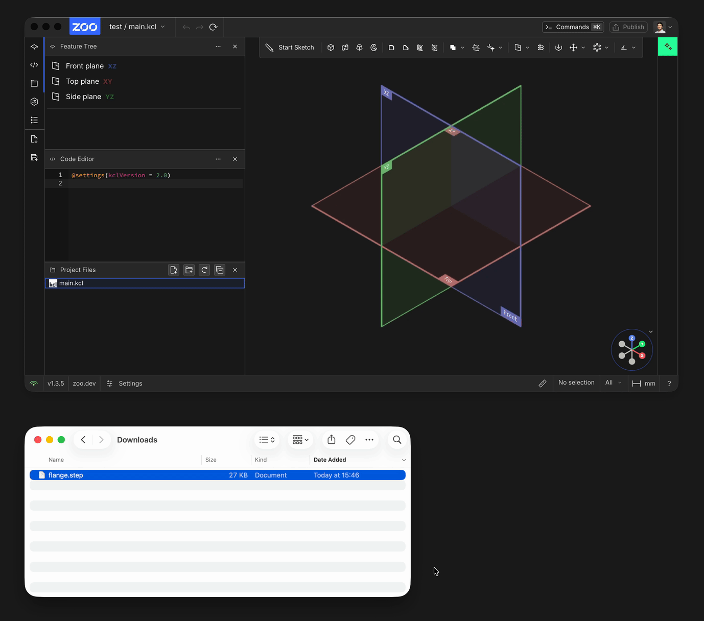

Add the STEP file to your project
Before importing a STEP file, make sure it is in the Zoo Design Studio project. The simplest workflow is to drag the .step or .stp file directly into the Project Files panel.
Dragging a STEP file into the Project Files panel in Zoo Design Studio
Drop the STEP file into Project Files when you want Zoo Design Studio to add it to the current project

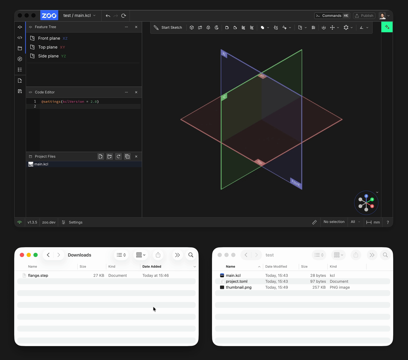

In the desktop app, you can also add the file outside Zoo Design Studio by placing it in the project folder next to main.kcl. After it is added, confirm that the STEP file appears in Project Files before referencing it from KCL.
Dragging a STEP file into the same project folder as main.kcl
Drag the STEP file into the project folder so it sits beside main.kcl

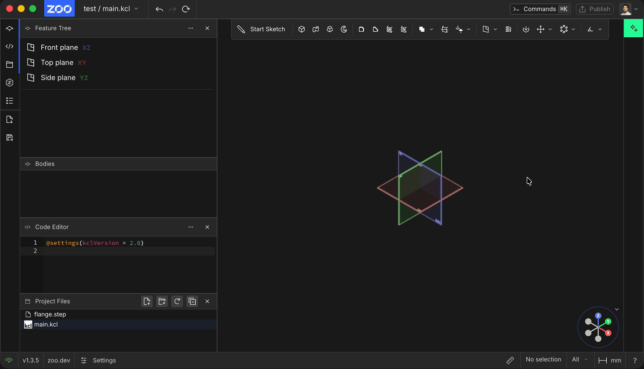

Add the STEP import to KCL
With the STEP file in Project Files, use the insert action to add the import statement to the active KCL file. Zoo Design Studio writes the import line for you, so you do not need to type the filename manually.
Using the Project Files insert action to add a STEP import statement to main.kcl
Use the insert action from Project Files to add the STEP import line to main.kcl
The imported file path is quoted and can be aliased with as. For a file in a folder, use a path relative to the project directory, such as "parts/flange.step".

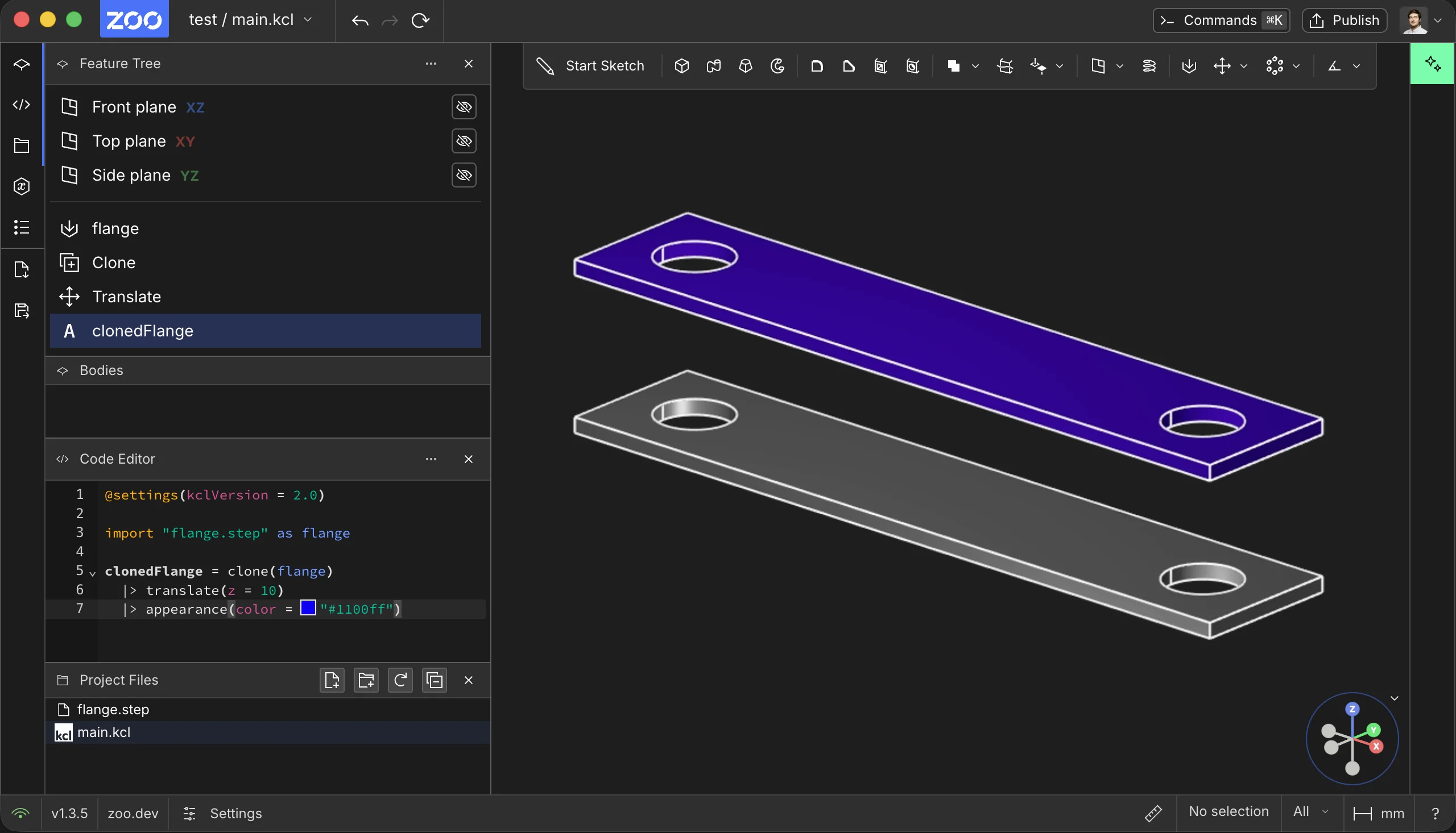

After import, you can transform, style, or clone the imported geometry. For example:
A cloned STEP flange translated above the original flange in Zoo Design Studio
Clone an imported STEP file when you want another instance while keeping the original as a reference
You can also transform the imported file directly when you do not need the original visible as a reference. Use clone when you need another instance of the same imported part.

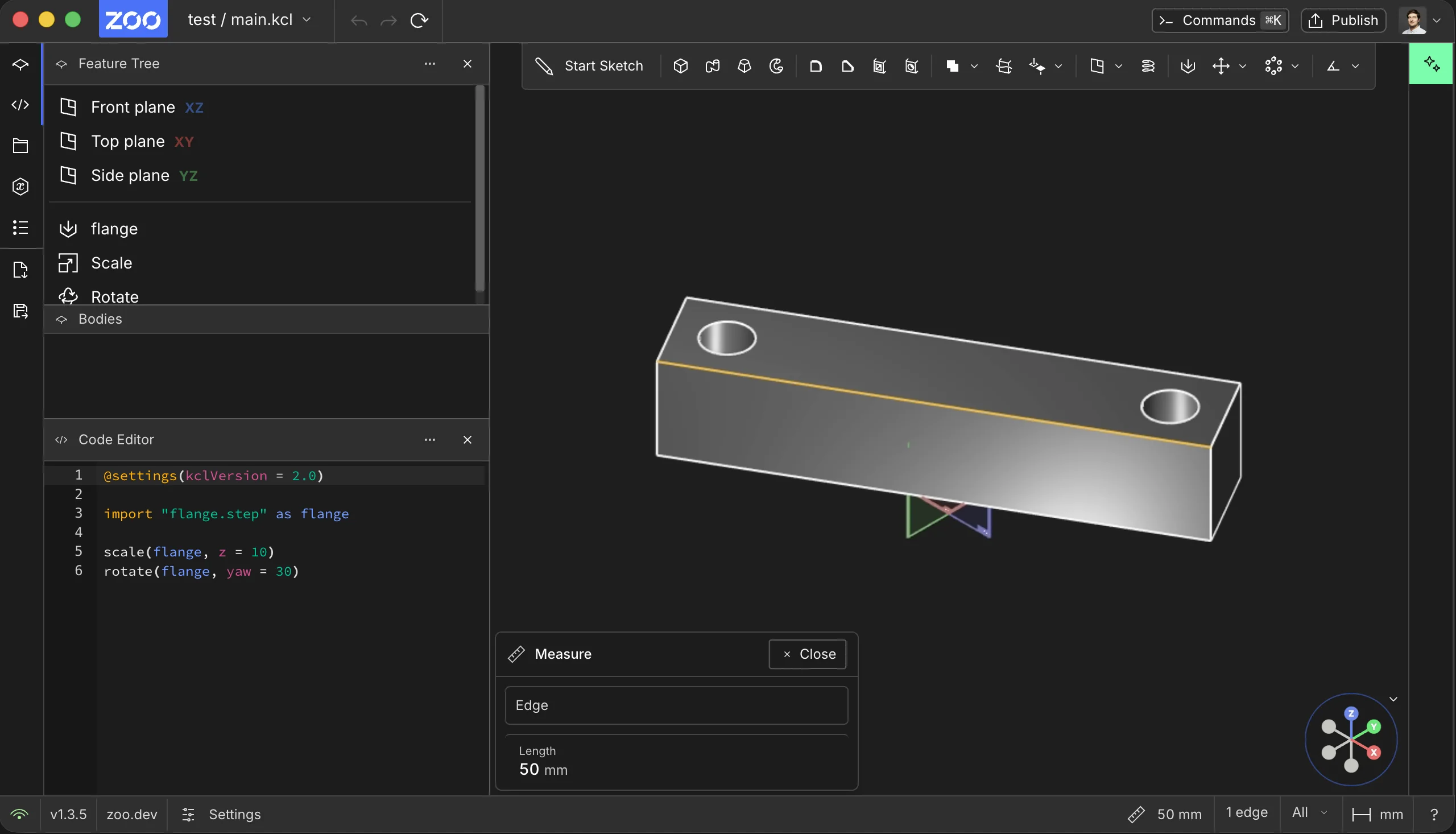

What STEP import supports
STEP files can contain precise CAD boundary representation (BREP) geometry and product structure. Zoo Design Studio imports 3D geometry from .step and .stp files in both the desktop app and the browser. It does not support importing 2D drawings from STEP files. In the browser, drag the file into Project Files; the Add file to project Local Drive picker is available only in the desktop app.
Imported STEP geometry:
  • appears as external CAD geometry in the scene
  • can be inspected, measured, translated, rotated, scaled, styled, and cloned
  • can be used as a visual reference while building native KCL geometry
  • cannot be edited directly after import; make changes in the source CAD system and reimport the file, or recreate the geometry natively in KCL
  • cannot be used for boolean operations, sketch-on-face, or other modeling operations that require interaction with other scene geometry
An imported STEP flange scaled, rotated, and measured in Zoo Design Studio
Imported STEP geometry can be measured and transformed in the scene, but it remains external geometry rather than editable native KCL feature history
If you need parametric edits or modeling operations that interact with other geometry, recreate the feature natively in KCL and use the imported STEP file as a visual reference while rebuilding the part.

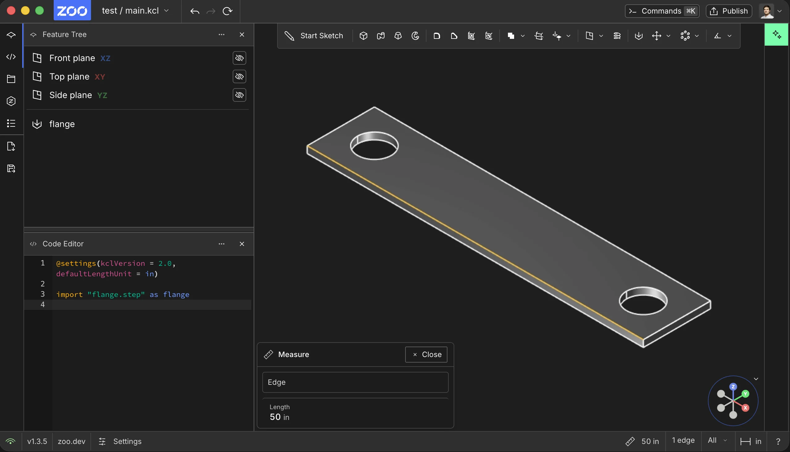

Units and scale
Zoo Design Studio currently interprets STEP numeric values in the current KCL file or scene unit. It does not rescale the imported geometry from STEP unit metadata. For example, if a STEP file was authored as a 50 mm part but the current file unit is inches, that same edge measures as 50 in after import.
A 50 millimeter STEP flange imported into an inch scene and measured as 50 inches
STEP values are interpreted in the current scene unit, so a 50 mm source model can measure as 50 in when the file unit is set to inches

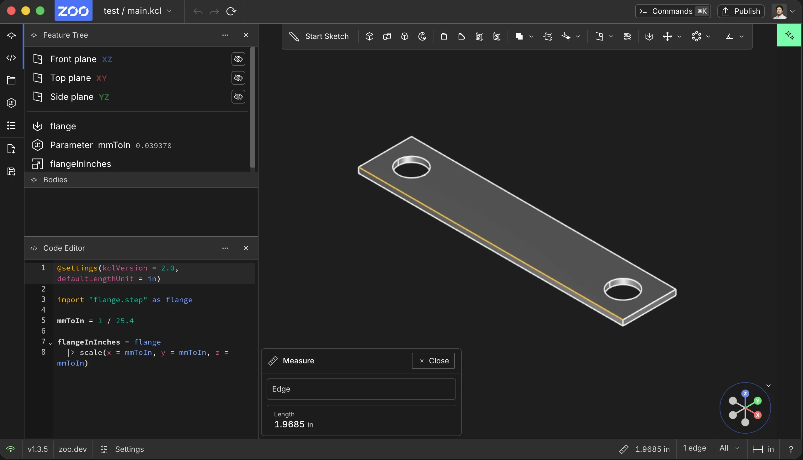

To preserve the intended size, set the KCL file unit to match the source CAD file before importing:
If you need to keep a different scene unit, scale the imported geometry after import. For a millimeter-authored STEP file in an inch scene, scale by 1 / 25.4:
A millimeter STEP flange scaled in an inch scene and measured as 1.9685 inches
After scaling by 1 / 25.4, the 50 mm source edge measures about 1.9685 in
STEP does not use the KCL lengthUnit import attribute. That override is for formats documented with custom length-unit support, such as STL, OBJ, and PLY.
