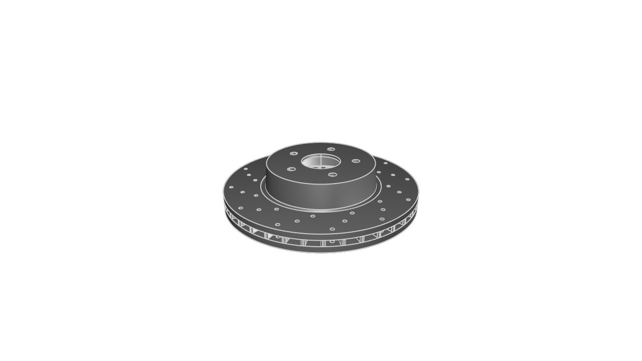

// Brake Rotor
// A 320mm vented brake disc (rotor), with straight vanes, 30mm thick. The disc bell should accommodate 5 M12 wheel studs on a 114.3mm pitch circle diameter.
