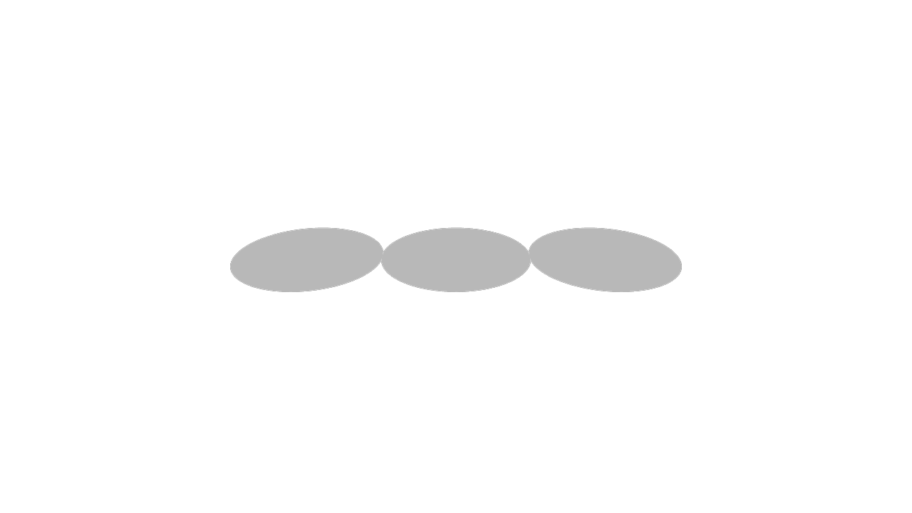

r = 10 // radius
fn drawCircle(@id) {
return startSketchOn(XY)
|> circle(center = [id * 2 * r, 0], radius = r)
// Call `drawCircle`, passing in each element of the array.
// The outputs from each `drawCircle` form a new array,
// which is the return value from `map`.
circles = map([1..3], f = drawCircle)
r = 10 // radius
// Call `map`, using an anonymous function instead of a named one.
circles = map(
[1..3],
f = fn(@id) {
