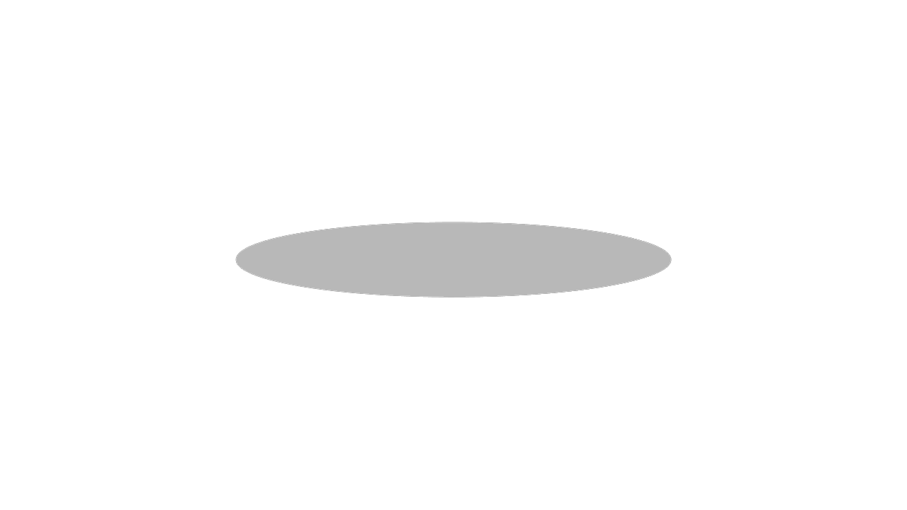

Construct a 2-dimensional ellipse, of the specified major/minor radius, centered at the provided (x, y) point.
