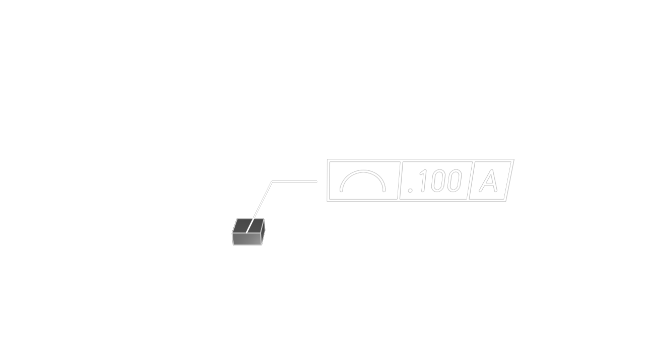

Rendered example of gdt::profile 0

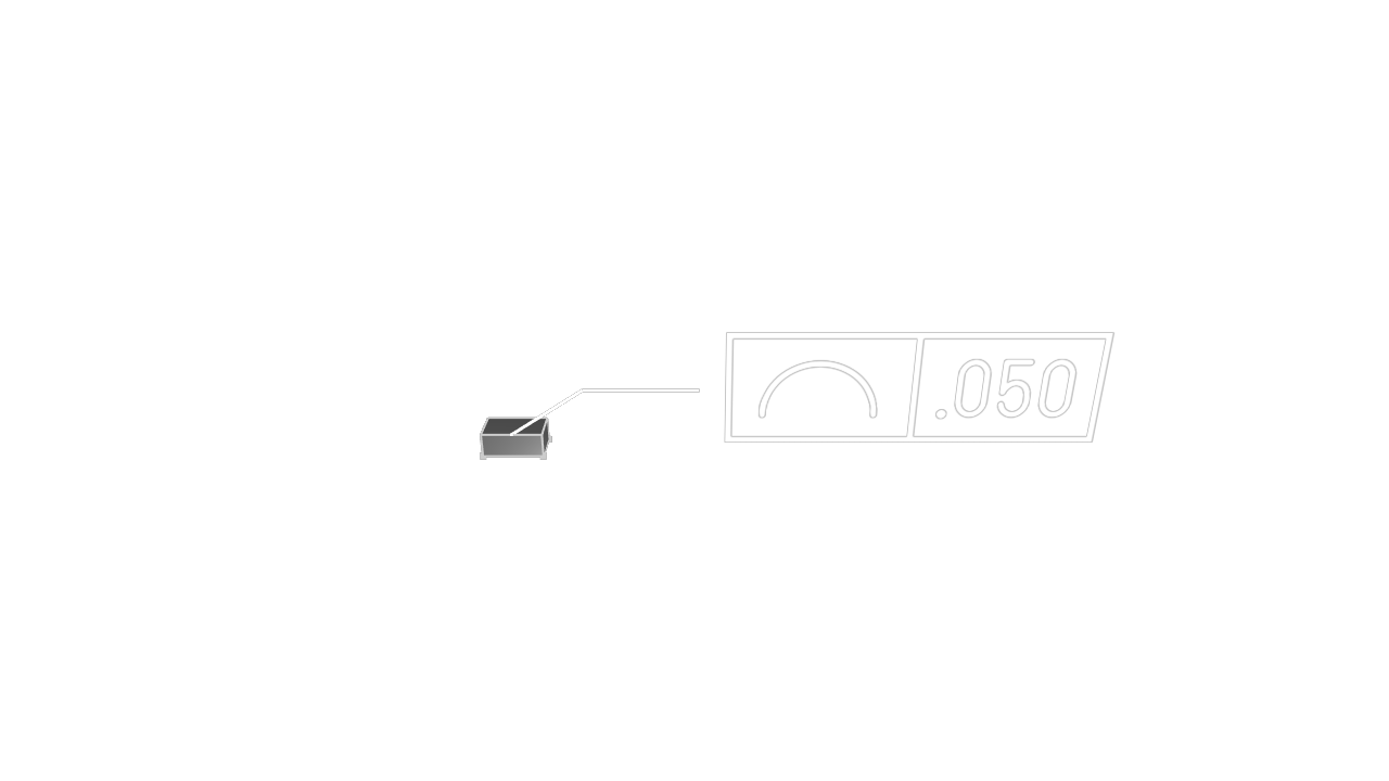

Rendered example of gdt::profile 1
