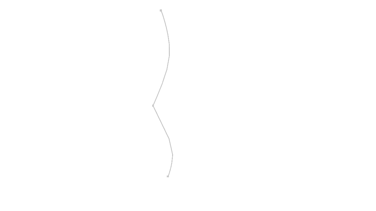

Extend the current sketch with a new involute circular curve.
This is part of sketch v1 and is deprecated in favor of sketch-solve and the gear module.
sketch | Sketch | Which sketch should this path be added to? | Yes |
angle | number(Angle) | The angle to rotate the involute by. A value of zero will produce a curve with a tangent along the x-axis at the start point of the curve. | Yes |
startRadius | number(Length) | The involute is described between two circles, startRadius is the radius of the inner circle. Either startRadius or startDiameter must be given (but not both). | No |
endRadius | number(Length) | The involute is described between two circles, endRadius is the radius of the outer circle. Either endRadius or endDiameter must be given (but not both). | No |
startDiameter | number(Length) | The involute is described between two circles, startDiameter describes the inner circle. Either startRadius or startDiameter must be given (but not both). | No |
endDiameter | number(Length) | The involute is described between two circles, endDiameter describes the outer circle. Either endRadius or endDiameter must be given (but not both). | No |
reverse | bool | If reverse is true, the segment will start from the end of the involute, otherwise it will start from that start. | No |
tag | TagDecl | Create a new tag which refers to this line. | No |
