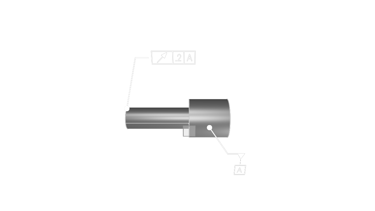

GD&T annotation specifying circular runout relative to a datum axis.
Runout controls how much a round feature may vary as it rotates around a referenced datum axis. It may be applied to circular edges or round faces, such as the wall of a cylinder. Datum references are required.
Runout is applied regardless of feature size and does not use MMC or LMC.

Rendered example of gdt::runout 0
