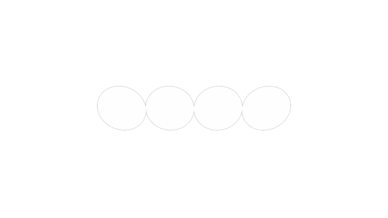

// Each instance will be shifted along the X axis.
fn transform(@id) {
return { translate = [4 * id, 0] }
// Sketch 4 circles.
sketch001 = startSketchOn(XZ)
|> circle(center = [0, 0], radius = 2)
|> patternTransform2d(instances = 4, transform = transform)
