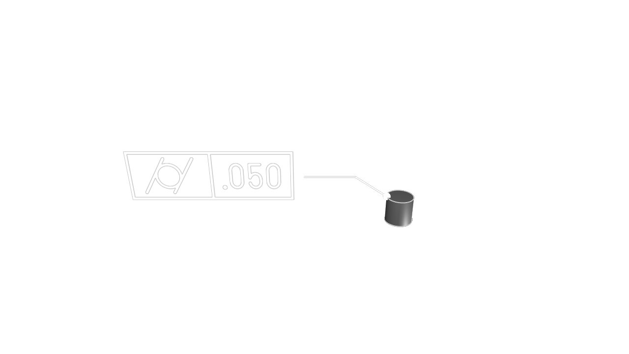

Rendered example of gdt::cylindricity 0

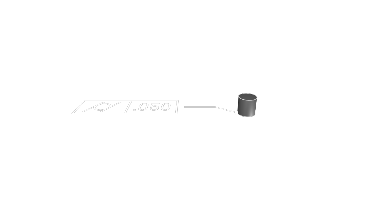

Rendered example of gdt::cylindricity 1
