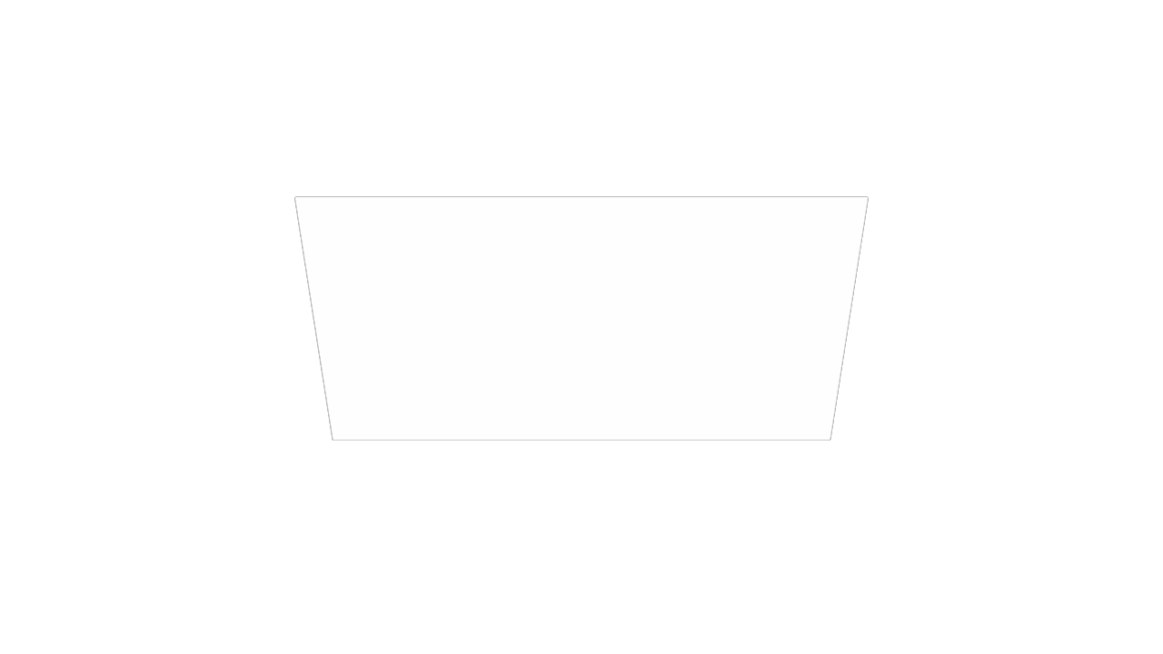

Sketch a rectangle.
This is part of sketch v1 and is deprecated in favor of sketch-solve.
A rectangle can be defined by its width, height, and location. Either the center or corner must be provided, but not both, to specify its location.
sketchOrSurface | Sketch or Plane or Face | Sketch to extend, or plane or surface to sketch on. | Yes |
width | number(Length) | Rectangle's width along X axis. | Yes |
height | number(Length) | Rectangle's height along Y axis. | Yes |
center | Point2d | The center of the rectangle. Either corner or center is required, but not both. | No |
corner | Point2d | The corner of the rectangle. Either corner or center is required, but not both. This will be the corner which is most negative on both X and Y axes. | No |
