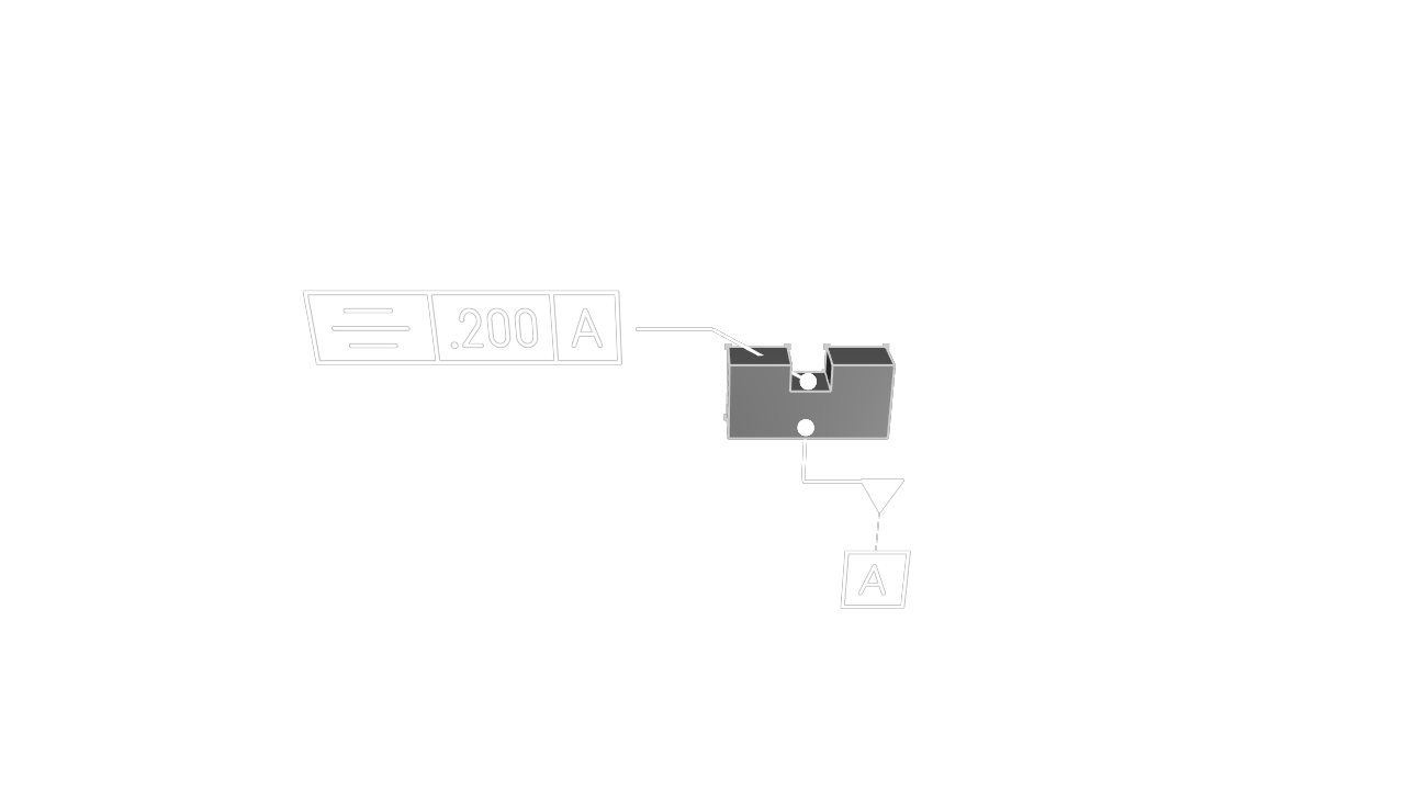

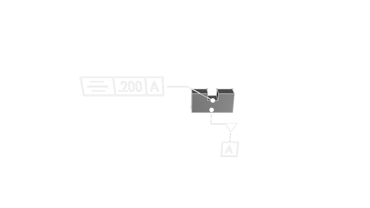

GD&T symmetry annotation specifying how closely a feature's median plane must align with datum references.
Symmetry is a location tolerance for features of size. It controls the derived median points of opposing feature surfaces relative to a datum center plane. The tolerance zone is bounded by two parallel planes equally disposed about the datum plane, with a total width equal to tolerance. Datum references are required.
Symmetry is the non-circular counterpart to concentricity. It is typically used where mass balance or form distribution about a datum plane matters, but it is difficult to inspect and is often replaced by position or profile controls where appropriate.
In American Society of Mechanical Engineers (ASME) Y14.5, symmetry is applied regardless of feature size (RFS) and does not use maximum material condition (MMC) or least material condition (LMC) modifiers.
tolerancenumber(Length)The total width of the tolerance zone between two parallel planes.Yes
datums[string; 1+]The datum references to display in the feature control frame. Supports up to primary, secondary, and tertiary datums.Yes
edges[Edge or any; 1+]The edges to be annotated. Edge specifier objects ({ sideFaces = [...], endFaces? = [...], index? = 0 }) are experimental; do not use them in generated or user-facing KCL yet.No
Rendered example of gdt::symmetry 0
Rendered example of gdt::symmetry 1
