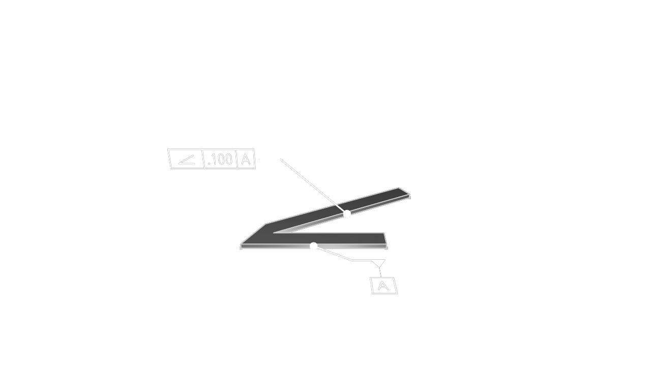

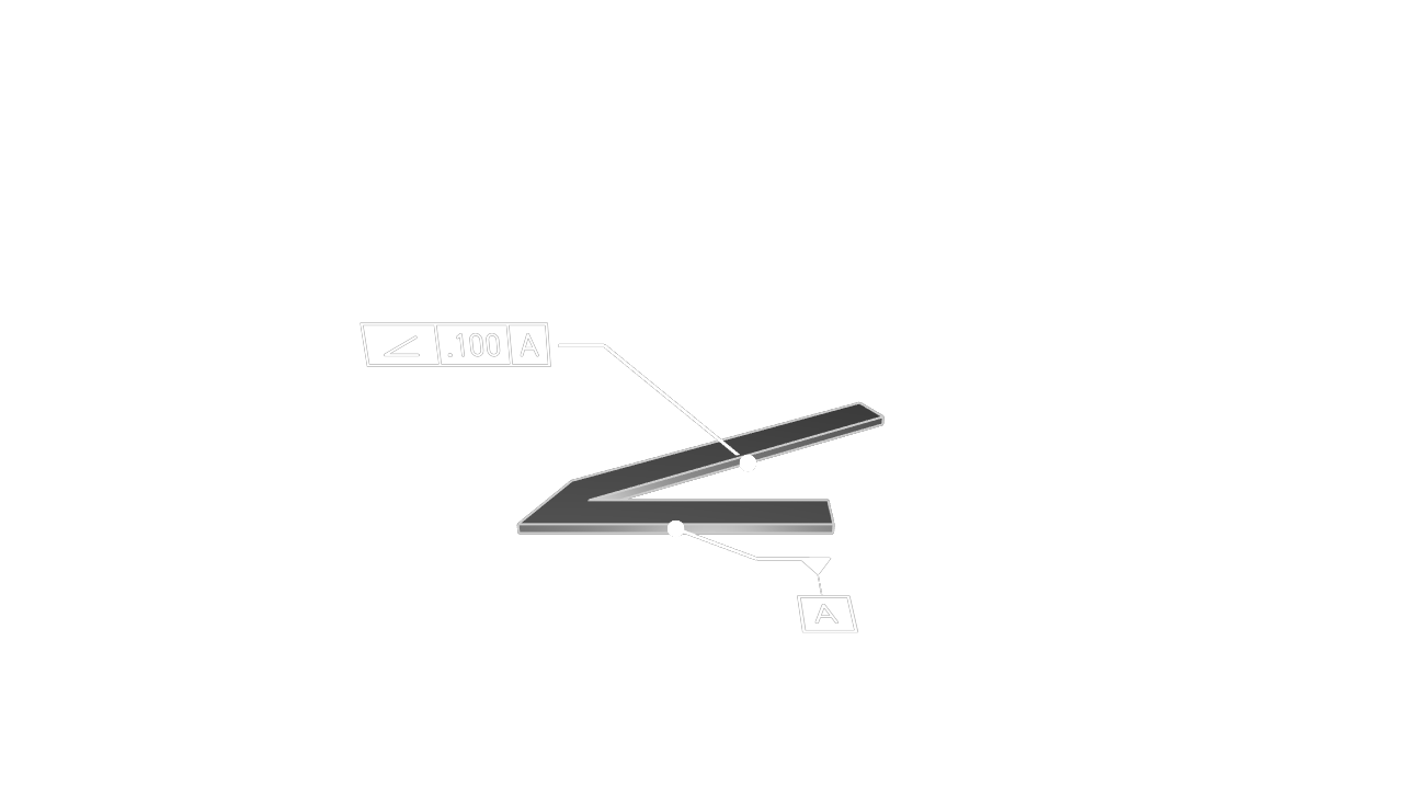

GD&T angularity annotation specifying how much faces or edges may deviate from an orientation at a basic angle relative to datum references.
Angularity is an orientation tolerance. The specified angle is a basic dimension in the drawing or model geometry. The tolerance is a length controlling the size of the zone, not an angular plus-or-minus value. Provide at least one of faces or edges. Supplying both is allowed, but omitting both is an error.
tolerancenumber(Length)The tolerance zone size for orientation at a basic angle.Yes
faces[TaggedFace; 1+]The faces to be annotated. At least one of faces or edges must be supplied.No
edges[Edge or any; 1+]The edges to be annotated. At least one of faces or edges must be supplied. Edge specifier objects ({ sideFaces = [...], endFaces? = [...], index? = 0 }) are experimental; do not use them in generated or user-facing KCL yet.No
Rendered example of gdt::angularity 0
Rendered example of gdt::angularity 1
