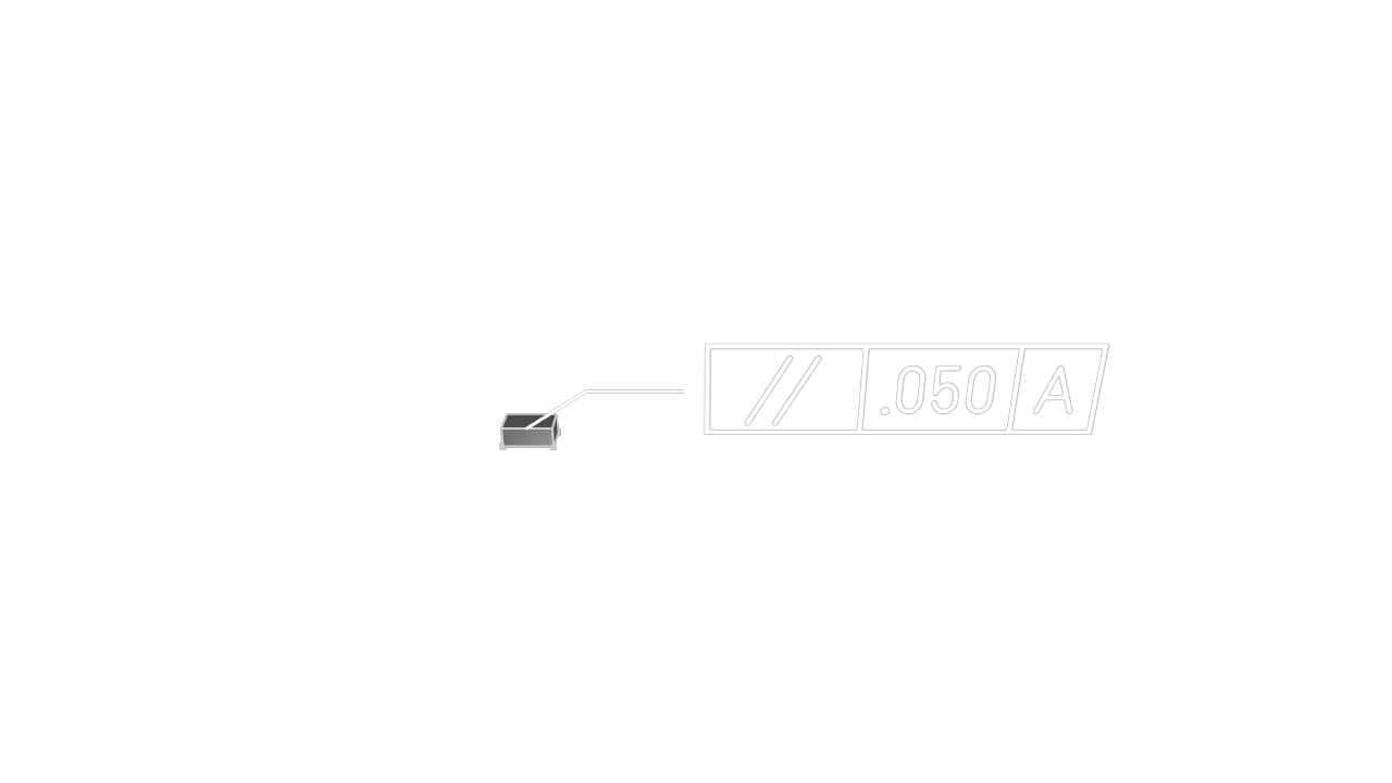

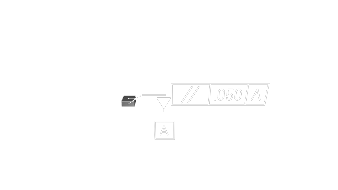

GD&T parallelism annotation specifying how much faces or edges may deviate from parallel orientation relative to datum references.
tolerancenumber(Length)The tolerance zone size for parallel orientation.Yes
edges[Edge or any; 1+]The edges to be annotated. Edge specifier objects ({ sideFaces = [...], endFaces? = [...], index? = 0 }) are experimental; do not use them in generated or user-facing KCL yet.No
Rendered example of gdt::parallelism 0
Rendered example of gdt::parallelism 1
